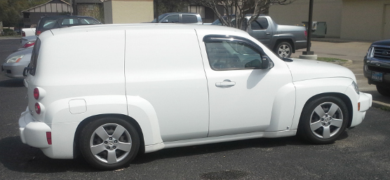

TxHotrod Mar 30, 2013 02:38 PM
1 Attachment(s)
I don't think I would mind if the rear raised up another half inch as these springs are LOWWWWW!!! LOL But I love the way it looks. Got a pic and I think it is safe to say the springs are now settled in.
Attachment 24389
