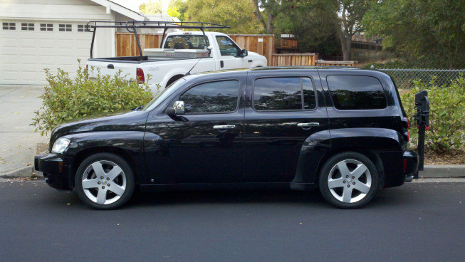

Figured i'd post a pic, as mentioned before I have the 09 Cobalt SS Turbo springs. They leveled it out pretty evenly. They are most defiantly stiffer than the stock springs and do improve handling. They are not "too stiff" and the ride is still very compliant. I already had a progress tech rear sway bar and that combined with the springs makes the rear end pretty much dialed. I'm looking at putting the FE5 setup up front now to finish it off. But I defiantly give to these springs , extremely cheap for a great upgrade.

I did the same, but with the SS/SC springs. I liked the rears, but when I later did the front, there was no noticeable difference in either performance or lowering. Just an FYI, but the turbo may be a little better.

I'm REAL tempted to grab a complete set of the FE5 fronts , the complete shock/strut setup shows up every now and then for a few hundred bucks and should be bolt in as far as i know. I wouldn't mind lowering the front a 1/2 inch.
