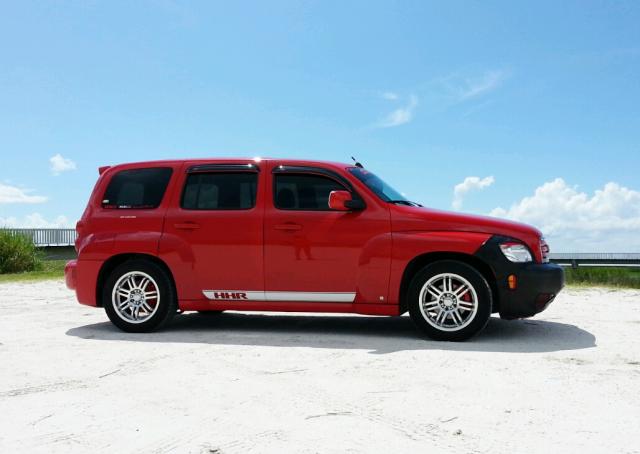

You really want the springs to level. Either cobalt ss rear springs or goldline leveling springs. I have the cobalt ss springs in the rear of mine. Dropped the back about an inch and a quarter. Perfectly level now.
