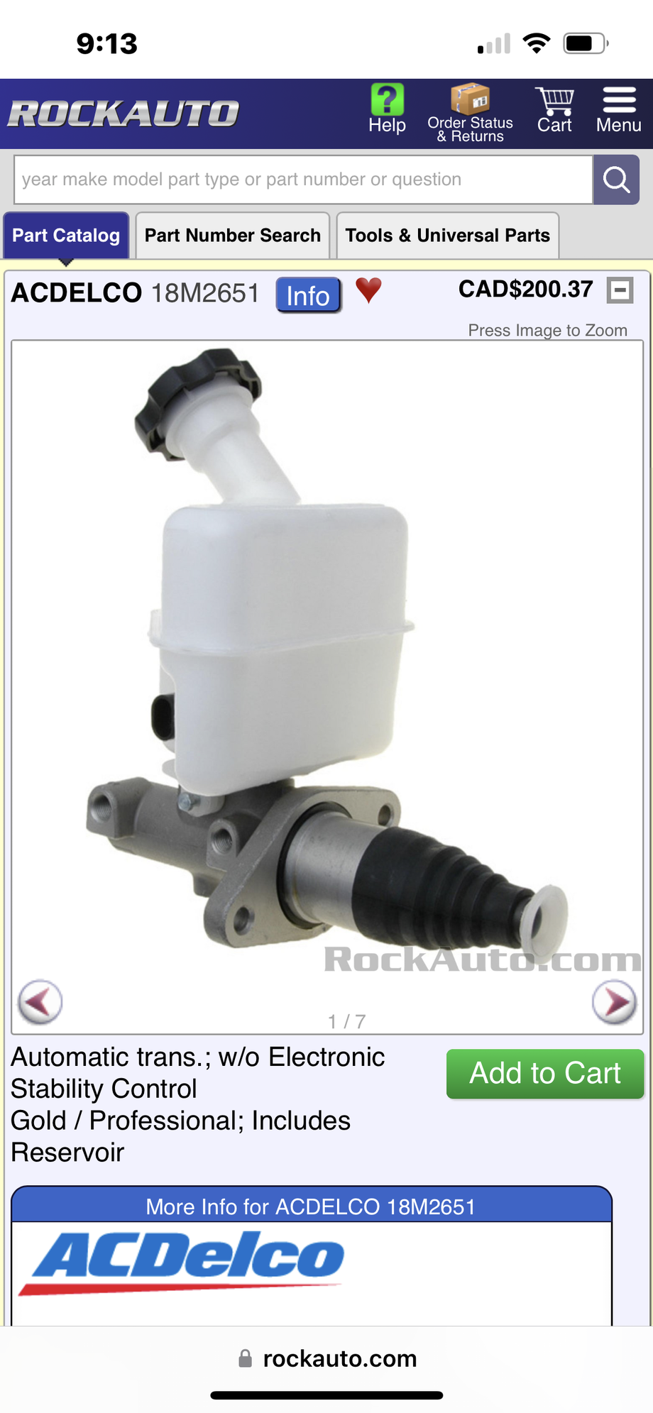

Found this on gmpartsdirect. What’s the difference?

Oldblue, that says gold/professional, isn't that typically a lower quality part?
Old Nov 6, 2023 | 09:15 AM
Posts: 40,082
Probably, I would order the GM 15939484 , that’s new from GM

I got off the phone with gmpartsdirect and they confirmed the one I bought originally ACDelco 1741153 is the correct one for my vehicle as the actual GM part is 15939484 which is the picture I posted from their website.
so it looks like I ordered the correct one, I guess I got a defective unit.
