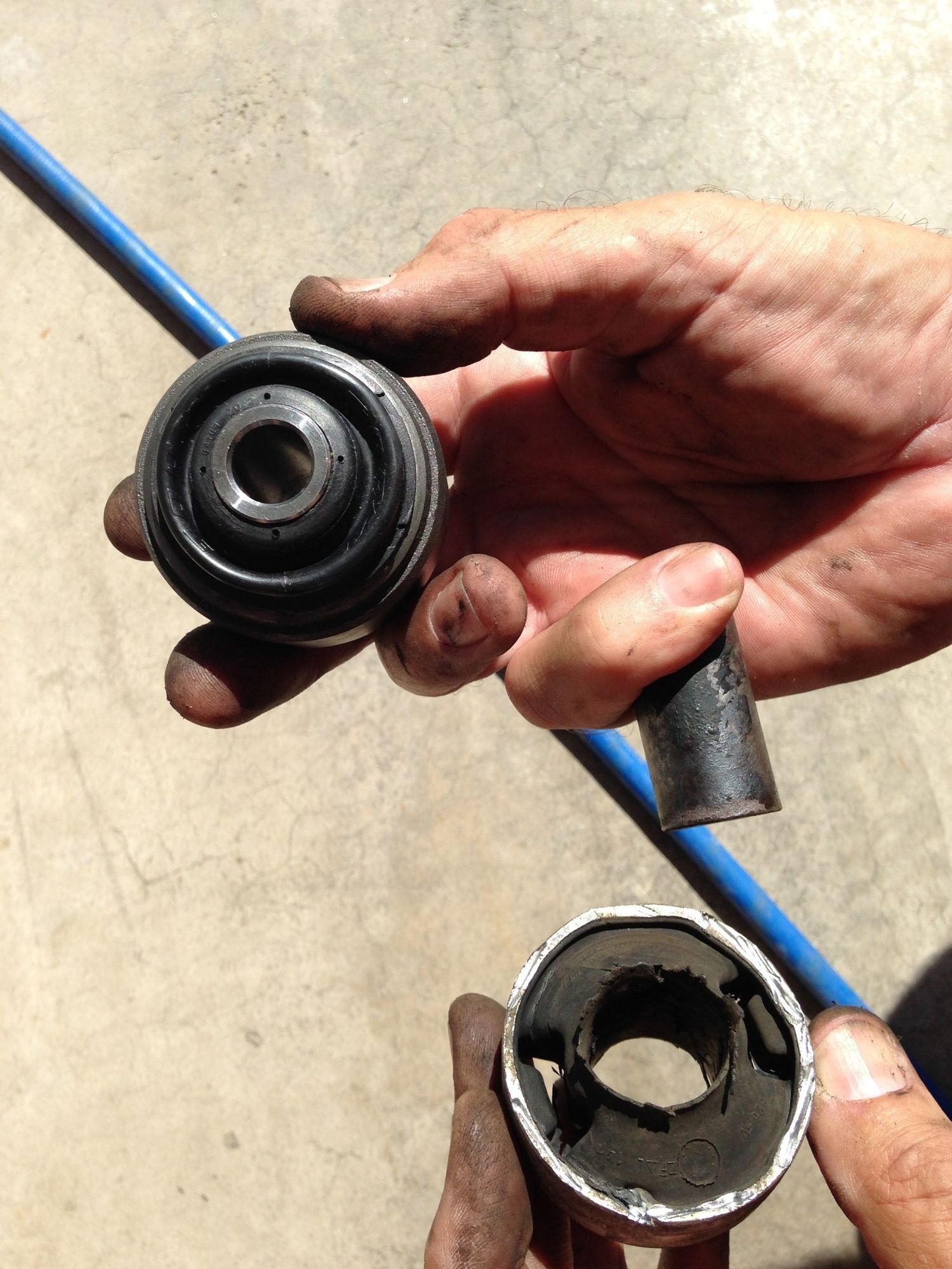

The none zinc coated K200792 version has been installed on Oldblue LCAs since early August 2015.
https://cimg8.ibsrv.net/gimg/www.che...565d0fa3f.jpeg
Old OEM on left, new Problem Solver on right

It is a completely different design. The center is a bearing, not just rubber.

Oldblue 04-10-2018 09:32 AM
A lot more !

A few years , couple of winters , no corrosion on the K200792 bushings.
They definitely fit the HHR, the zinc coated ones will work to
