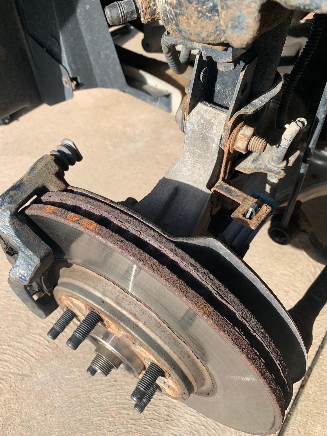

The noise is coming from my disc brake passenger side front. i guess it must be something else.

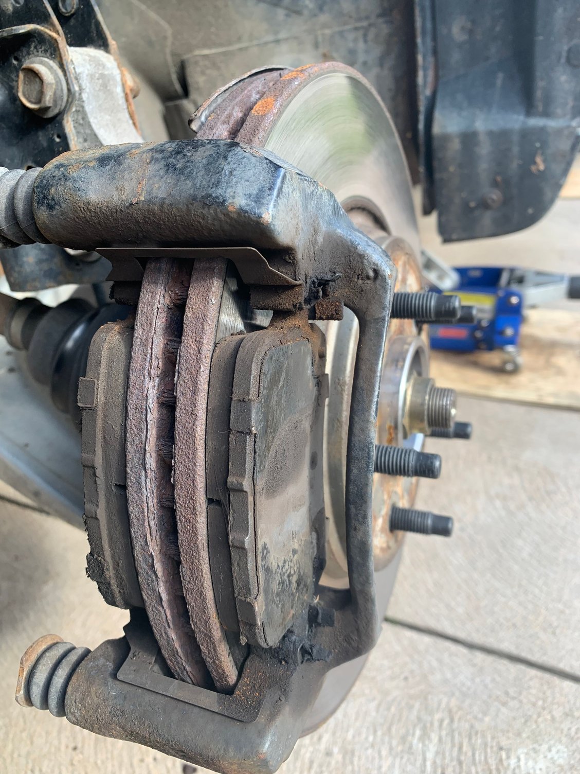

I’m moving your issue to a new thread, to avoid confusion and you really don’t have the same exact problem ( that other thread involved rear brake drums.
several things to look at here, have you just completed a brake job, if so what was replaced.
If not, then are you doing the work or taking it to a shop?
If you are doing the, if fairly easy , inspect the front rotors for grooves on the brake friction surfaces
inspect the brake pads, are both the same thickness, or is one side thinner then the other?
have a look at the back splash shield, any bends, is it touching the rotor?
is the metal tab on the inside pad touching the rotor?
See the pads how they are evenly worn
See the splash shield is touching the rotor, check the caliper slide pins , they should move easily in the caliper bracket
