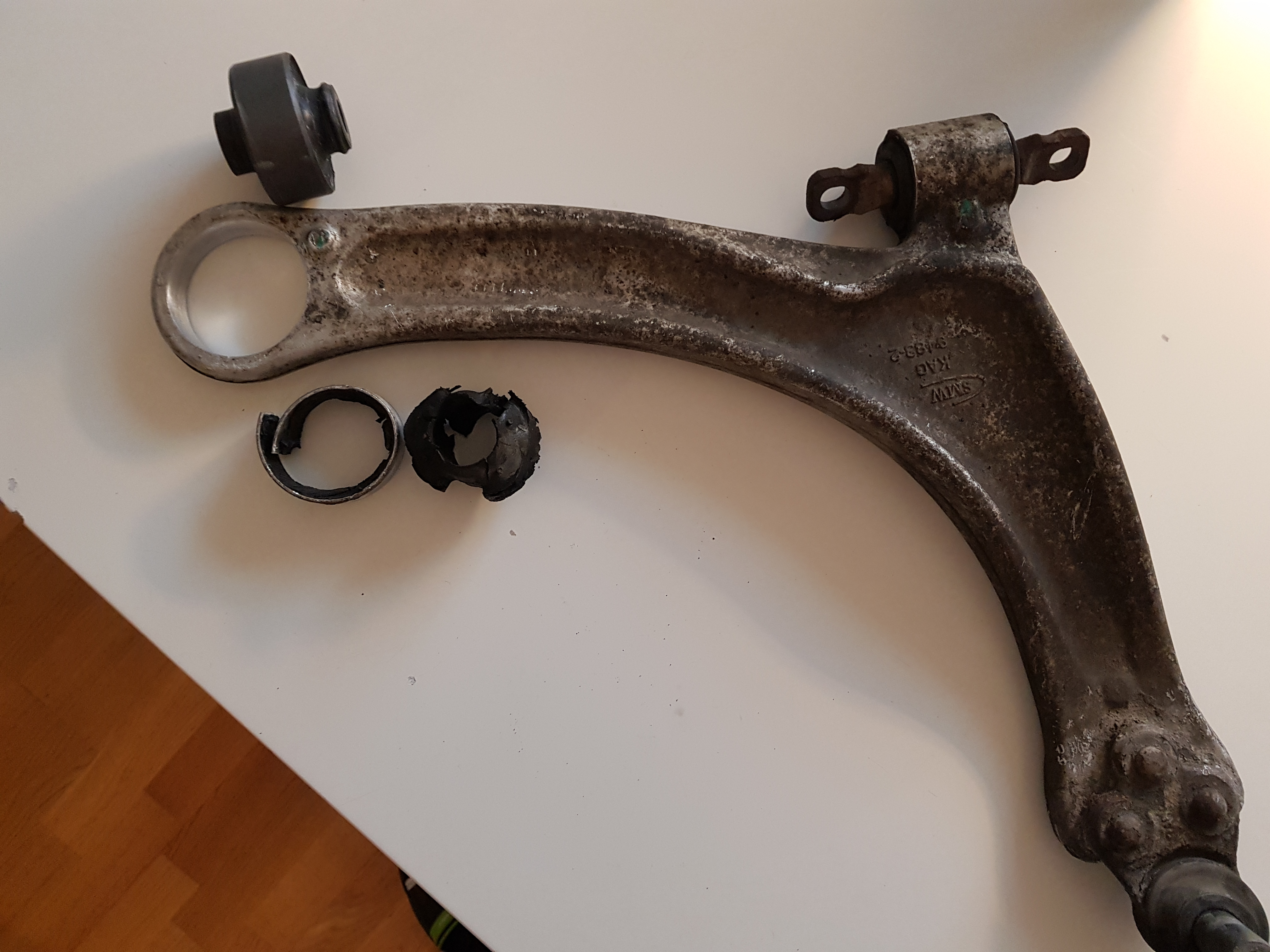

Hi, today removed the LCA from my 2006 HHR with 102000 KM
The rear bushing was very bad, got also the bolt spinning at the end but It was just to pulling out with another key while screwing out with an Impact Wrench.
Removed the old bushing from the LCA with a small saw and then with a hammer and a flat screwdriver.
Just have to wait until tomorrow to fix the new one bushing with an hydraulic press at my work
Also need the part number of that bolt, anybody can help me with this?
Thanks!

Old Oct 29, 2017 | 09:10 AM
Posts: 26,532
Bolt 11589009, surprisingly on eBay about $8.
Be aware that there is a mark to be lined up with the bump on the arm.

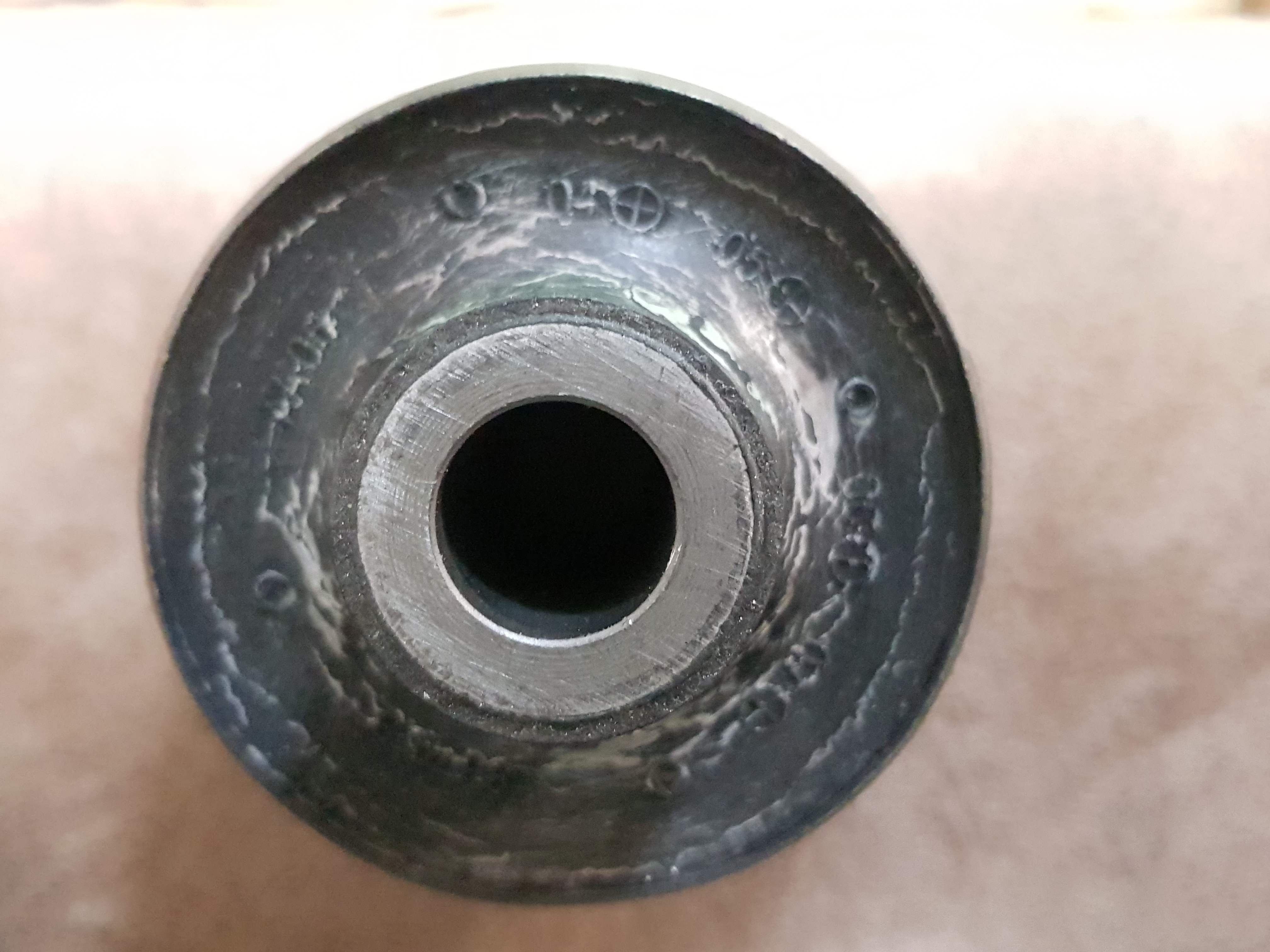

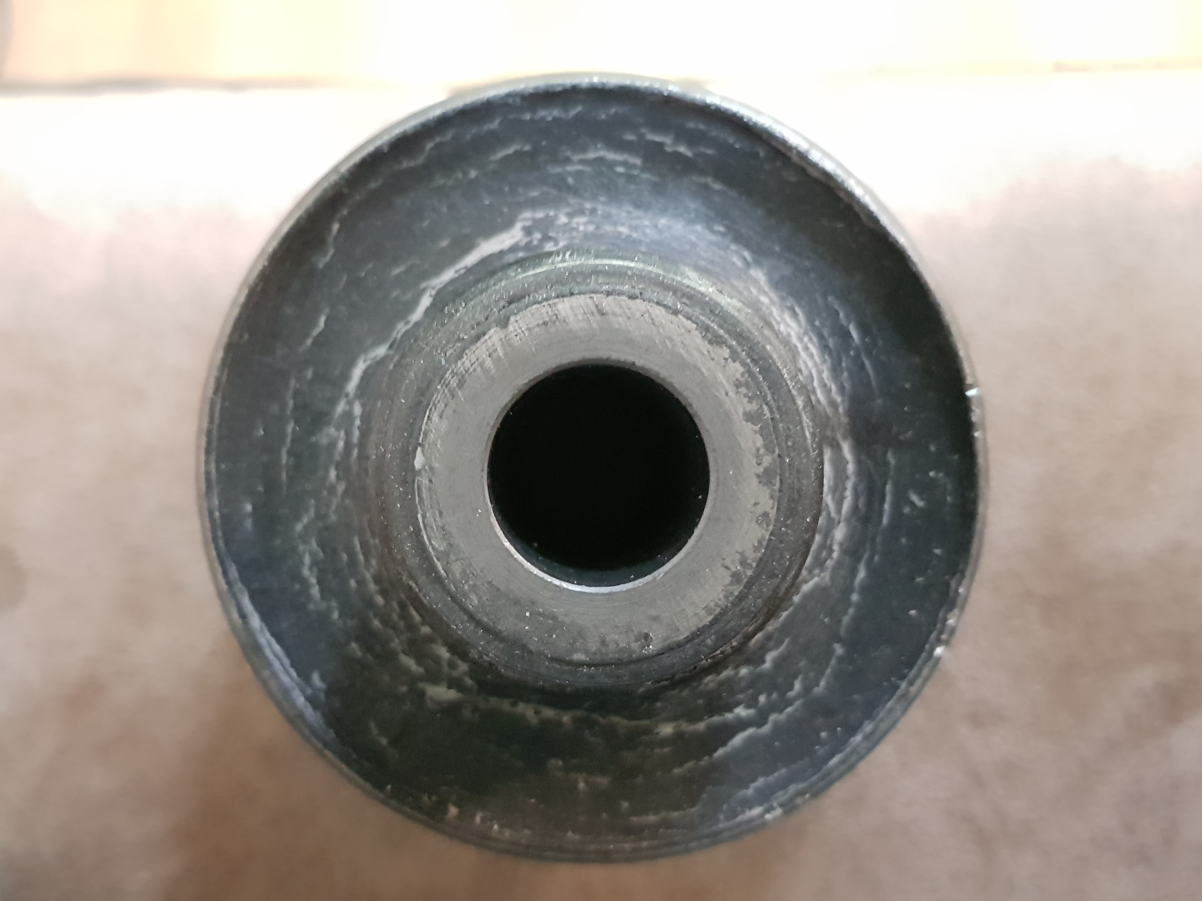

Hi, thanks, witch one?
Can you take a look at the bushing.
Attached Thumbnails replacing lower control arms/bushings-20171029_175513.jpg   replacing lower control arms/bushings-20171029_175602.jpg
Old Oct 29, 2017 | 12:54 PM
Posts: 40,082
That’s a solid aftermarket bushing, the OEM must be installed timed for the pivot points of the bushing see the solid piece, not the open space
I know this is an aftermarket, i will install this temporally (can´t find here the LCA), i bought the both sides LCA but have to wait until November 11 to arrive from the USA, i can´t be w/o the car, so this will be replaced again when i get the new LCA.
