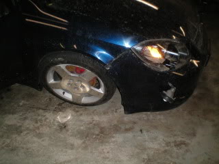

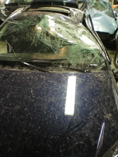

i rolled my cobalt sport once at 60 mph. I switched lanes and didnt see a puddle on the interstate. Puddle turned me into the center barrier and my car rolled once. Came out with a couple scratches. So i got another gm car. My hhr.
