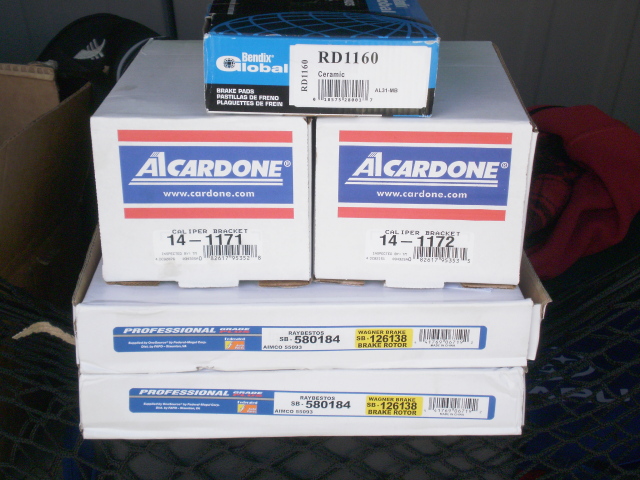

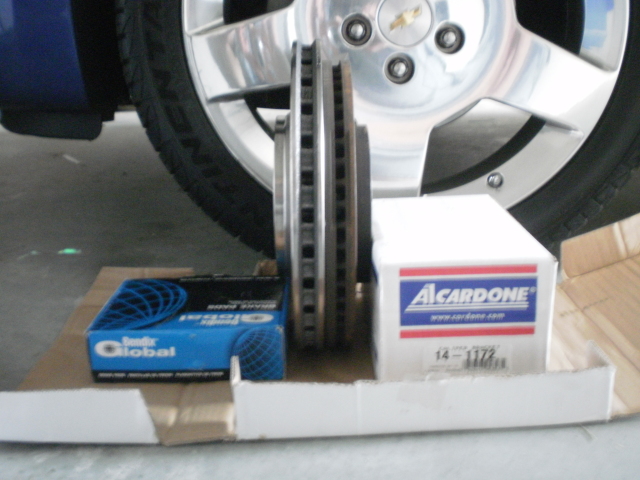

First, gather the parts you will need.
Attachment 25266

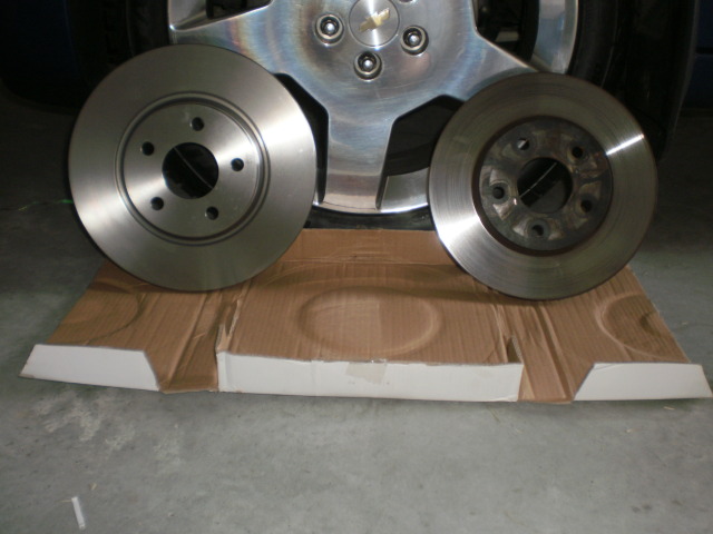

Here is a comparision between the standard HHR rotor and the non Brembo SS rotor.
Attachment 25267
Attachment 25268

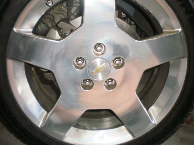

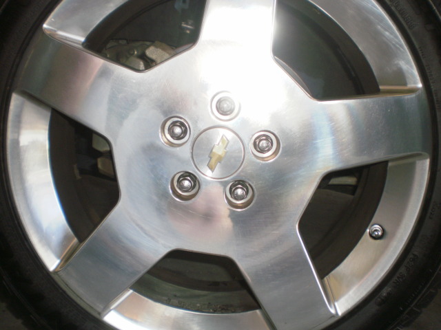

Shot of the stock rotor behind the wheel. The Cobalt wheel has a large center plate.

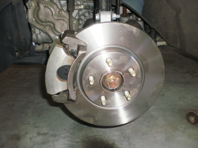

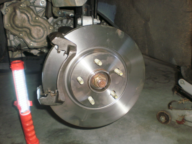

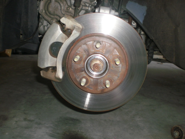

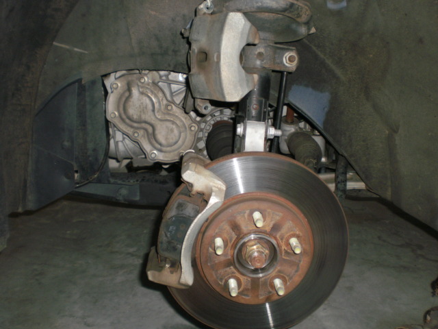

You will need to raise the wheel off the ground, and support the car. Once you remove the wheel, this is the stock setup.

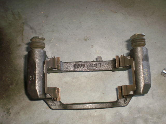

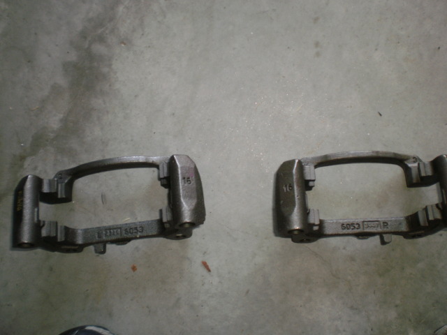

Before you dig in, seperate the two new caplier brackets. They are marked L and R.

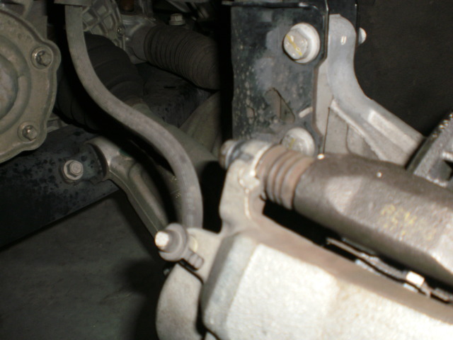

Remove the 2 bolts from the back of the caliper and support it. I use a heavy gauge wire off the strut spring.
Attachment 25272

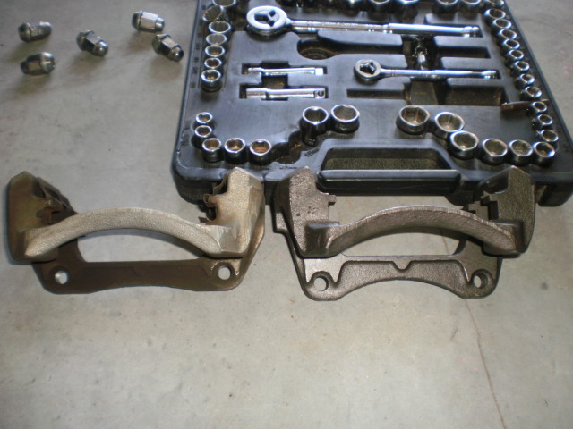

Then you can pop out the pads and remove the caliper bracket. Here is a comparision of the standard verses the SS.
Attachment 25273
You will need to transfer the hardware from the old caliper bracket to the new one. Make sure the caliper pins have plenty of grease.

With the caliper bracket off, the rotor will slide right off. Swap it with the new SS rotor and bolt on the new caliper bracket.

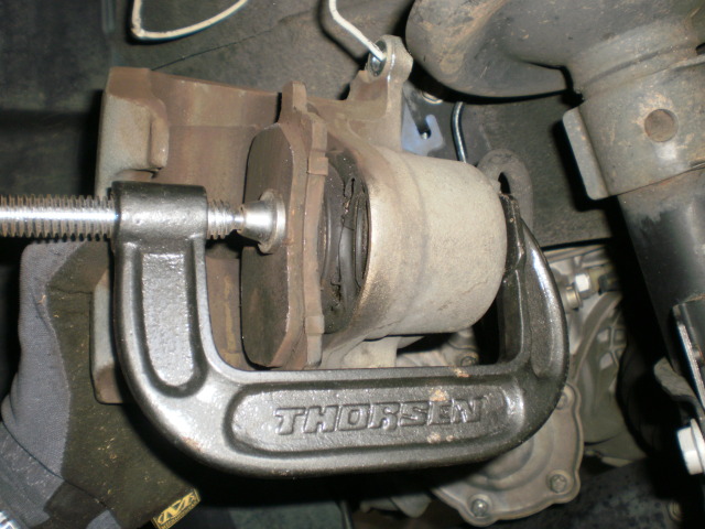

Before you can put the caliper back on, you will need to compress the piston back in. I use a 4" C-clamp and one of the old pads. Yes I saw the rubber material on the caliper. It's looked like that since the first time I saw it. Doesn't leak.
Attachment 25276

Will this setup work with stock 1LT 16" steelies?
solman98 09-22-2012 06:14 PM
Good question, but looking at the space I still have between the caliper and wheel, I'd think it would clear 16's also.

Just a though on the rubber material on the caliper. That is not a seal, but a dust boot. If you get brake dust on the piston and then force that piston in, you could damage the seals. Then..it will leak...lol
I would replace those boots the next time you do your front brakes....or at least take them off and clean the piston before using the clamp to push the piston in.
I made this mistake on my chev express and it leaked until I finished installing my new pads and seated them by pressing the brake pedal.....the piston cam back out to where it was clean.....whew.
