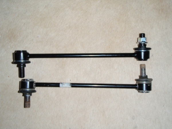

I buy links. Toyota (Camry, Avalon, Solara and Lexus LS300).
Length 260 mm, is 10 mm longer than the link HHR.
HHR-link bit rusty In The photo , I pulled it out of my suspension.
Heads are nearly identical.
The length and thickness of the threaded pin is the same.
Toyota thread a little smaller than the Chevrolet thread. But I think it no problem.
Want to know how much I paid? 900 rubles for a couple of good-quality Korean-made links! That's about $ 32. If the service experience will be successful, I'll buy a Toyota links in future.
Part number: 84780.

Those should be fine, geg...... good deal!

Gee, geg just a few posts back you were saying you couldn't trust cheap Chinese parts, but now cheap Korean parts are OK hehe.
Make sure the threaded shaft is the same diameter, so that it fits the holes snugly.

Looks like they are, but the threads are different.

But different thread pitch doesn't matter if just bolting thru.
Let us know Geg, how they work out.
