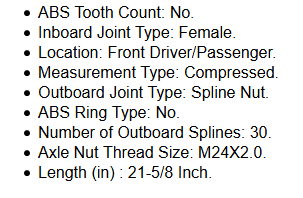

GM8206/179206 is for Malibu, G6, Aura etc.
Sometimes you have to lie to the counterman. Take a tape measure with you to check measurements, remember the tripot is a slip joint, so you have a little wiggle room.
This is the spec for gm8206

Alright gang, we've got confimation from another member that is using the GM8206 axles, and they work!

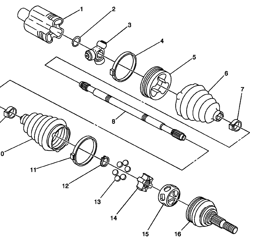

I too can confirm the GM8206 CV axle works in an automatic SS. I own 3 Auto SS cars and one stick shift. My kid crashed one of the auto SSs and I needed to get a new CV axle for the passenger side. When I yanked what was left of the OE axle out, it looked like this:
The transmission end is a male 27 spline shaft. The GM8206 axle is a female 27 splined socket and wasn't going to work for me. So, I set out to find an axle that fit. Many axle comparisons and purchases later, I gave up looking for a new one. So, I pulled one out of my other SSs and was going to use it. As I was about to install it, I felt the male transmission side shaft jiggle and clunk ever so slightly. So, I looked closer and realized it is a stub shaft that is splined on both ends and is removable:
So, I went and bought a GM8206 axle from my local O'Reilly's and it worked flawless. Cost me $83.
So, for future mechanics reading this, if the splined stub shaft between the CV and the 4T-45 differential comes out with the CV axle, go ahead and pop it out and install it in your new GM8206 CV axle and all will be right with the world.
