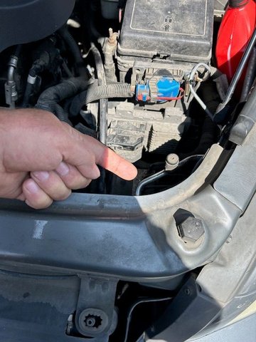

So my wife left her dome light on and drained her battery. I jumped started her now I'm getting multiple messages, no speedometer, and the car wont shift out of 1st gear. In the message center it says "service ESC" ,"Service traction" ," ESC off" & "power steering" (power steering is working)
OBDWIZ comes back with a permanent code U0101 Lost communications with TCM. The TCM fuse ? #43 under the hood is good ECM fuse # 25 in pass compartment is also good. did I fry the TCM? I did not realize that I connected the negative jumper cable to the TCM case (I couldn't find any bare metal under the hood)

Update
On the possibility that I melted the ground wire on the TCM I temporarily grounded the case of the TCM to a bodyground and amazingly the message center alerts disappeared !! (its typical I found the hidden negative jumper cable lug after I messed it all up) I will have to connect something more permanent before a test drive
. Should I ground the TCM to the body or the ECM case

Hidden grounding lug
disregard my temporary test wiring

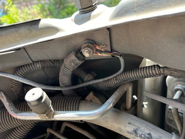

Originally Posted by donbrew
Where exactly did you connect the jumper wires?
Not paying attention I connected the negative jumper cable to the TCM case (it was 5:00 am I was half asleep wife was trying to get to work)
which must have melted the ground wire on the TCM harness. I see now that the case isn't grounded/bolted to the body. With the temp grounding wire its working as it did before
