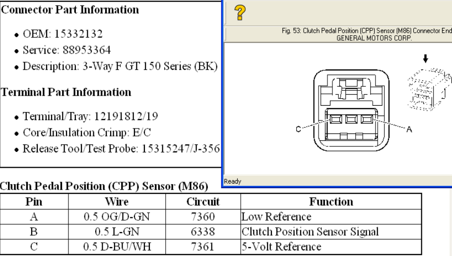

Would anyone happen to have a wiring diagram or can get me a picture of the pigtail that plugs into the clutch switch on the clutch pedal. I have a 2010 hhr lt with the 5 speed. I have found stuff but none of the colors match up to what I have and don't want to fry anything. The idiot i bought the car from had took the switch off and pulled the pigtail off the wires but luckily he kept the plug and I was able to repinn it now I just need to fund out what wires go where on the plug as I already installed the new switch. Thanks for anyone who can help.

There is a link to FREE shop manuals in my sig.
Old Mar 26, 2025 | 08:28 AM
Posts: 40,082
There ya go! Thanks Donbrew!
