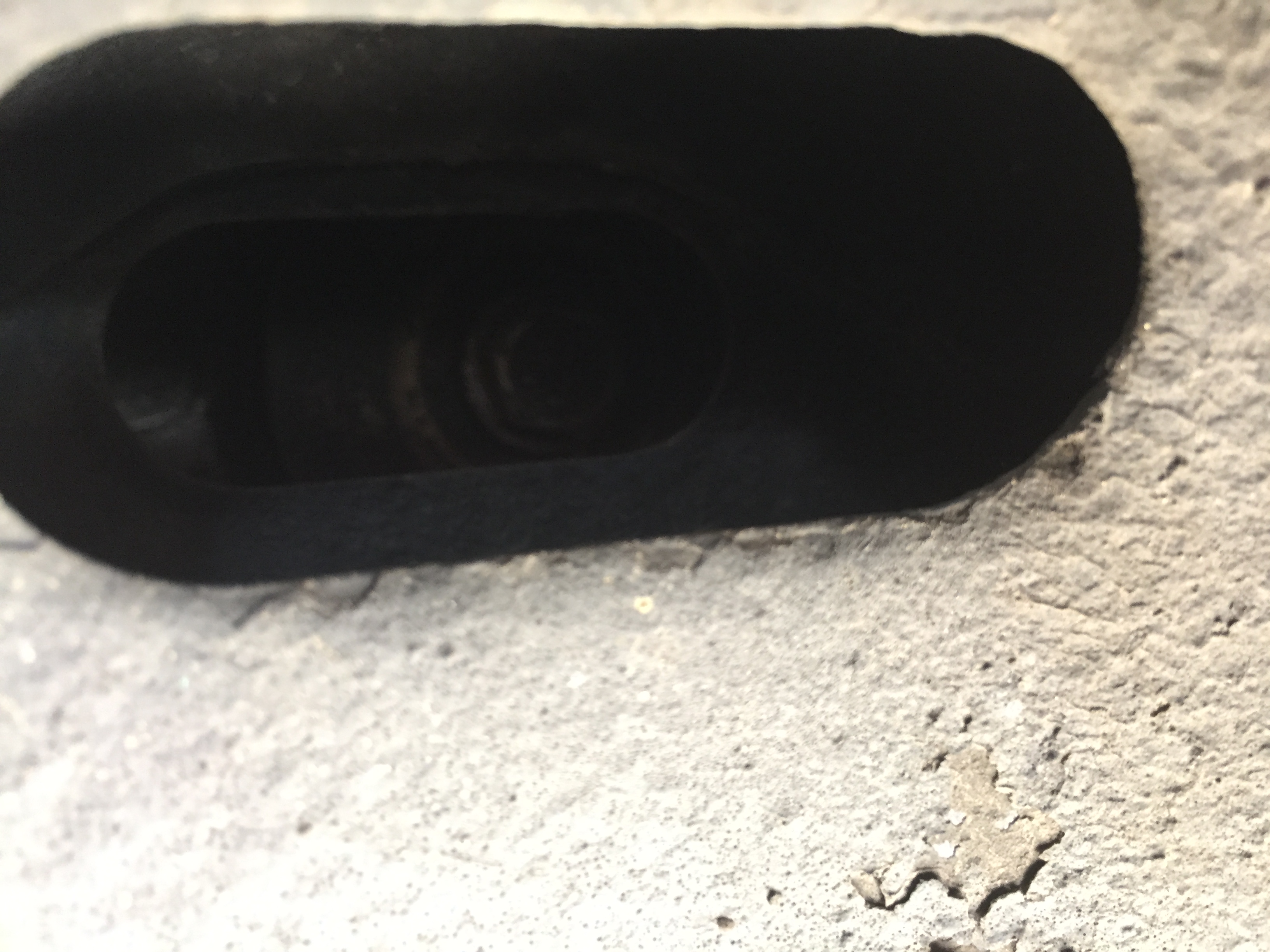

Yes. LOOKS okay but it still is a rubber part it's probably hardened up pretty good I'll replace it someday since it's easy enough to. Gonna wait until I need a new serpentine belt

Look at the hole inside the passenger side fender if that bolt is more than halve way below it, your motor mount is shot!
Also look at the bottom of the mount if there’s an oil like goo there , it’s toast!
