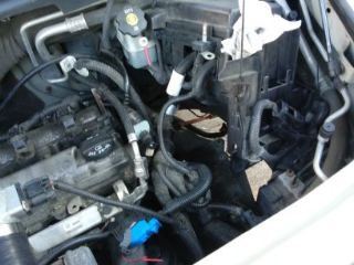

Very do-able
Just enough to wiggle cover out
Cleared as much as needed
Tied clove hitch to hood strut bowline base of plastic fuse box that would drop down on hood close. & lift on open (breaks needed)

Murph, did you catch the trans fluid after you cracked up the trans cover? Or did you drain the whole trans at the pan underneath?

Drained
Drained & new filter plastic trash can lid was there to catch small residual drops
lifted fuse box at an angle wasn't necessary to break it apart just gave it a firm press after bolted back in
Old Jul 14, 2021 | 09:28 PM
Murph's Avatar
Joined: 06-11-2013
Posts: 24
From: Nassau , New York
Lifted fuse box
Tied to strut
Tilted enough for new mounts too
