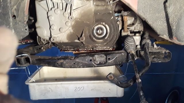

Originally Posted by fastsuv
Now I unbolted the remaining transmission mount. I reached up from the wheel well and removed the bolts, which are mounted from above. It was easy to do by feel. I then lowered the transmission until it looked like the cover would clear the wheel well opening. I turned the adjustment on the tall jack stands and it lowered the transmission. Watch carefully for any interference from hoses or wires (I didn't have any). The exhaust flex joint didn't really bend, the whole front part of the exhaust system dropped with the engine. I also had to drop the subframe another inch or two because the lower transmission cover bolts were now starting to go behind the subframe again as the trans is dropped.Here is a picture with the transmission dropped:
I made a homemade catch pan by hanging a bin box that I had under the transmission cover so it would catch the fluid as it came out:
I am doing this same job except on my car I have a base plate for a tow bar and it sticks thru the front facia. Only about 1/2” clearance and the base plate mounting bars are under the front sub frame bolts. So it looks to me like I am going to have to remove the tow bar and the front facia of the car. I did all that when I put it on but I can remember what all is involved. Is there a post or link where someone shows doing this?
never mind…found video. Thanks
