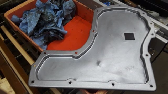

After the subframe was raised up fully and bolted back (with the transmission attached to it) I dropped the bottom pan and changed the filter.
Here are a couple of pictures:
Inside of bottom pan:
Inside of trans with bottom pan removed, looking up into trans:
