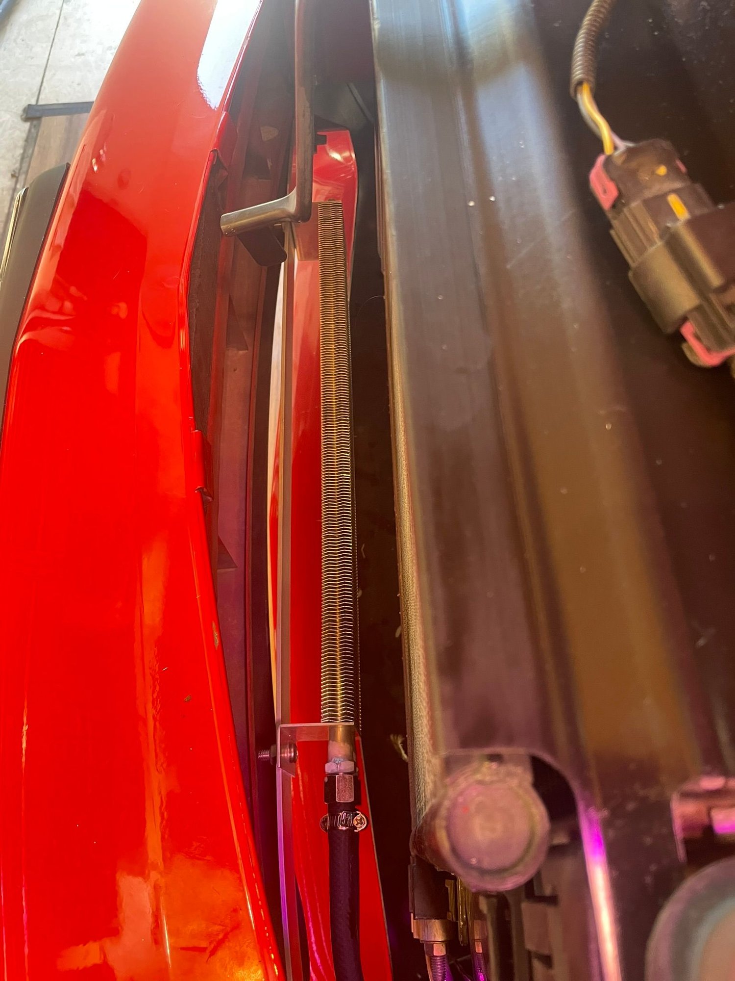

The rubber flaps around above radiator and driver's side need to be removed, along with the hood latch. I mounted the cooler on a piece of aluminum flat bar stock from Home Depot and installed it behind the bumper using the 2 bolt studs stick out from the bumper itself. I believe the nuts needed are 8X1.25. In this location there is a gap between the cooler and condensor, which allows for better heat transfer. Some mount the transmission cooler directly on the condensor, I won't do that.

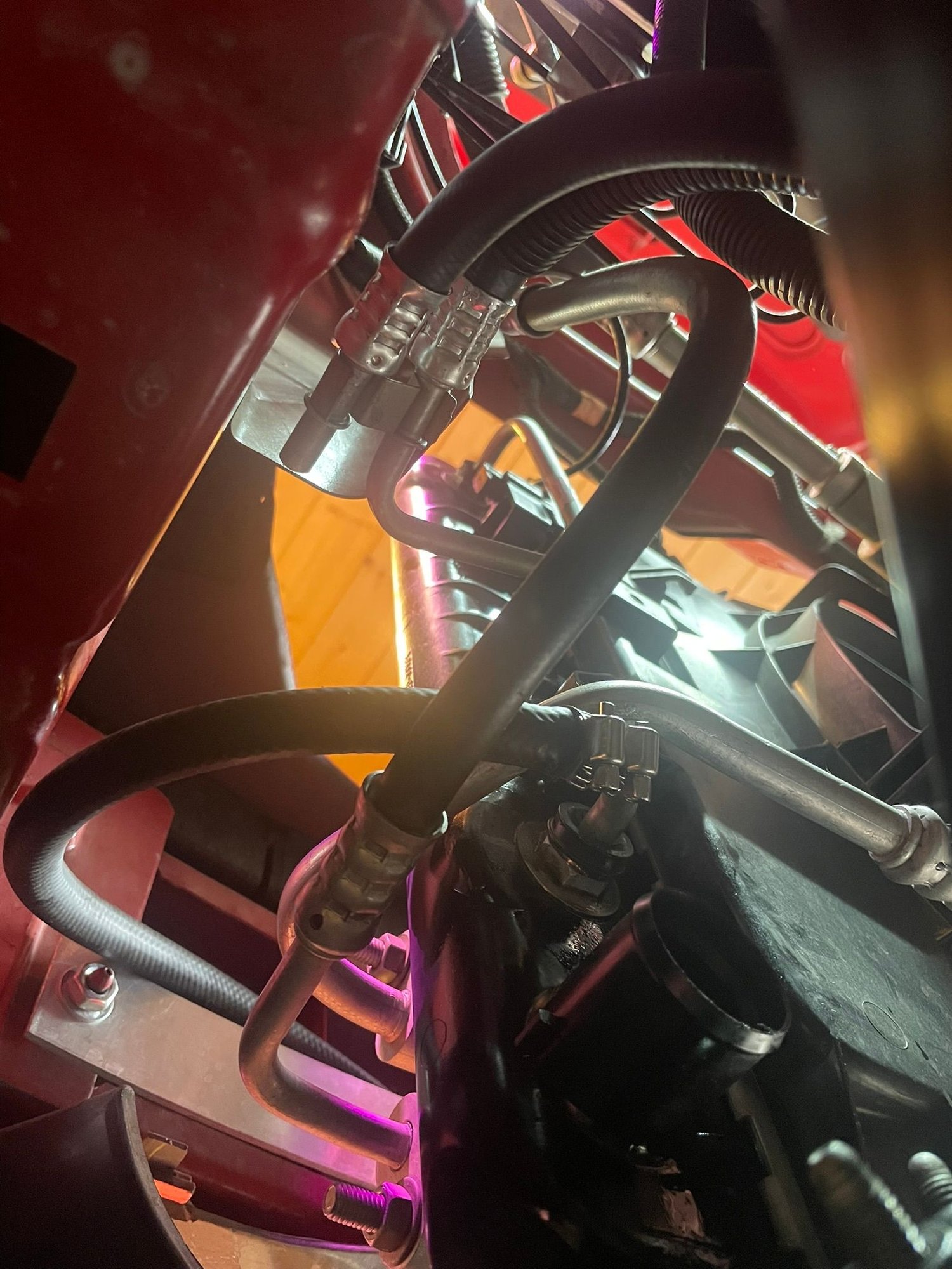

I installed the hose onto the cooler line before installing the cooler line to the transmission and used 2 clamps instead of one. Installing the assembly onto the tranmission while trying to route everything is extremely difficult, be patient. The A/C lines will also be in the way, be careful with those as you don't want to break one! NOTE- have the Jesus clips in place before this proceedure on both the upper and lower radiator connection points. The line fitting just pushes into place on the radiator after the Jesus clip is properly installed, very easy.

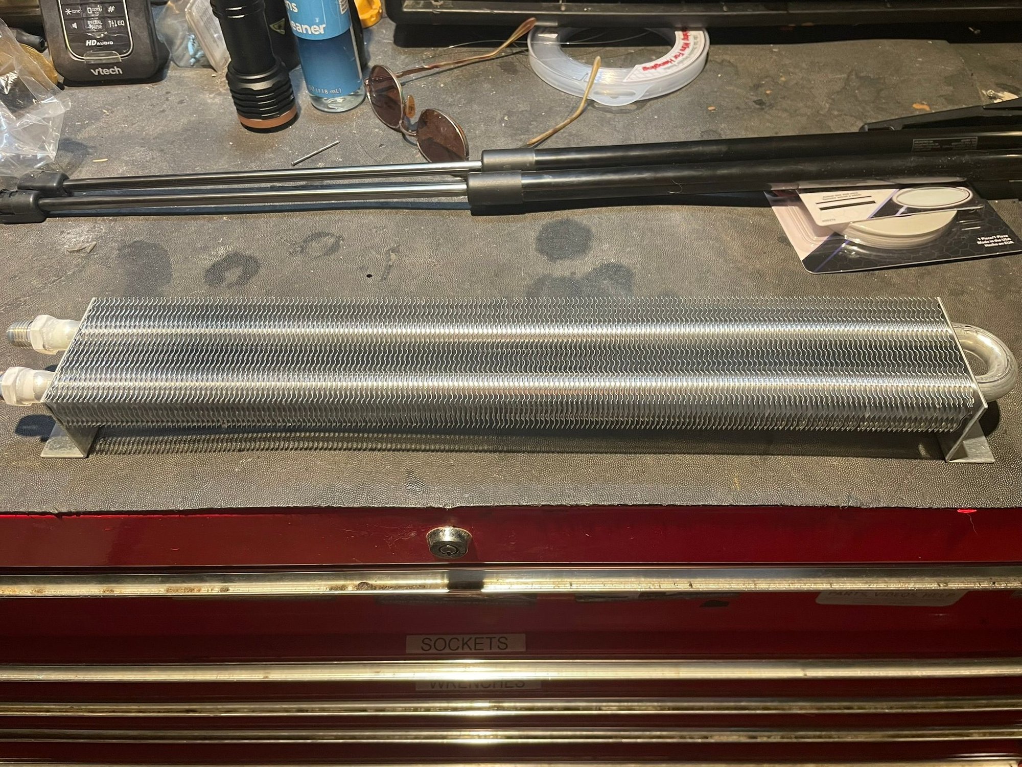

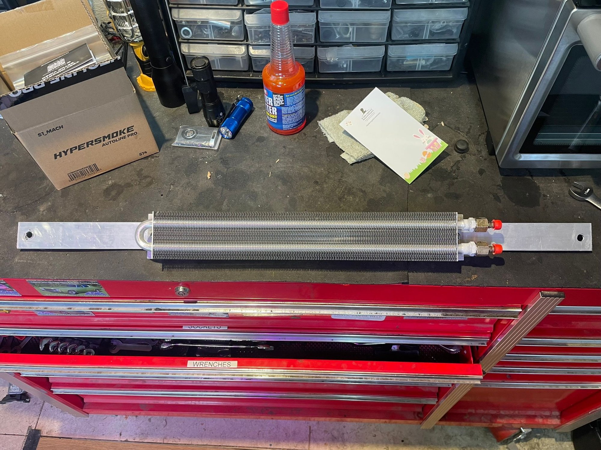

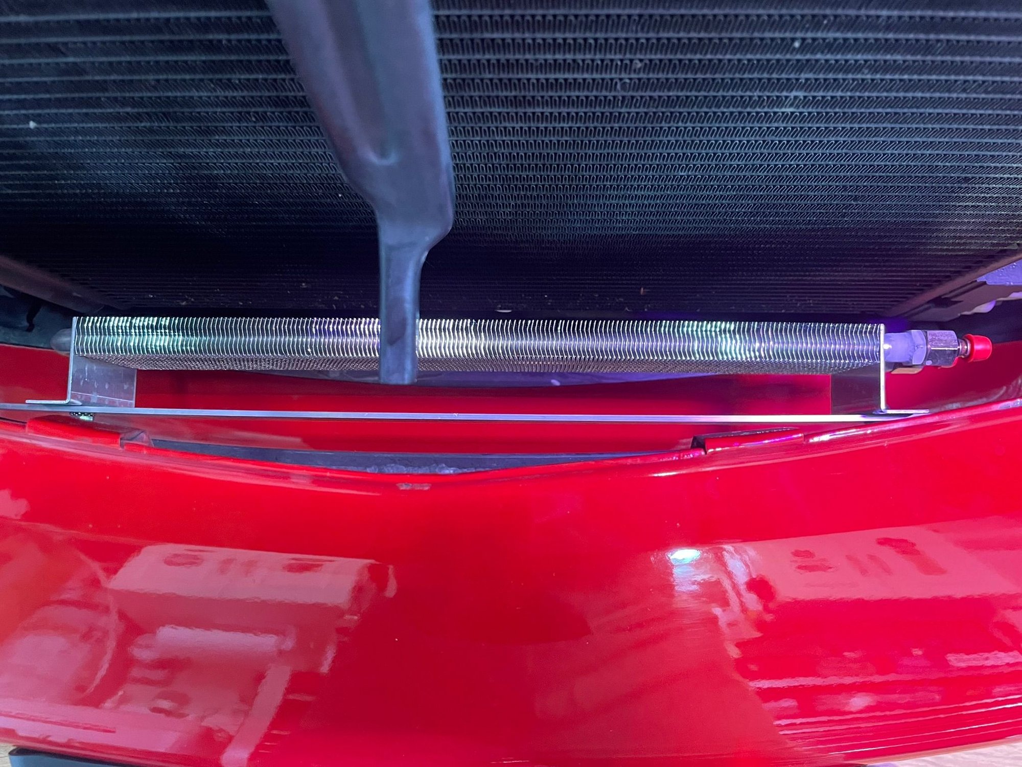

The cooler mounted on the aluminum flat bar. The holes have to be elongated slightly because the bolts on the bumper are not parallel.

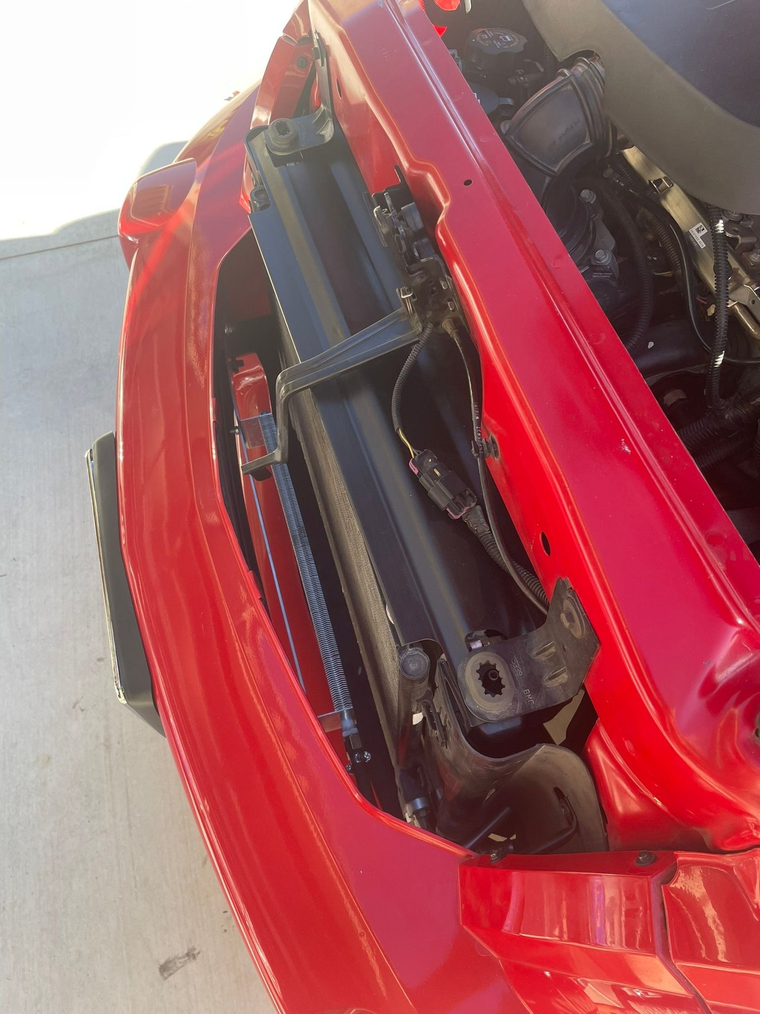

The cooler in place before it was connected to the transmission.

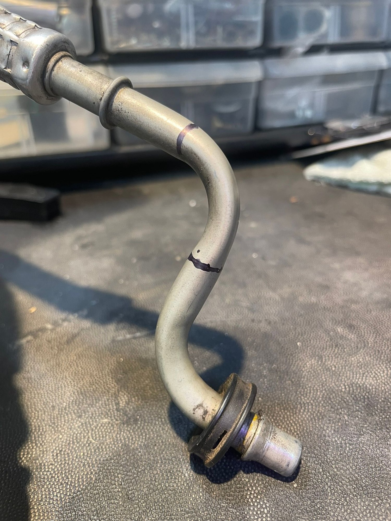

Cut the return line pipe where you see the 2 black lines. The new cooler is plumbed in between these 2 points. The stub goes into the lower radiator port.

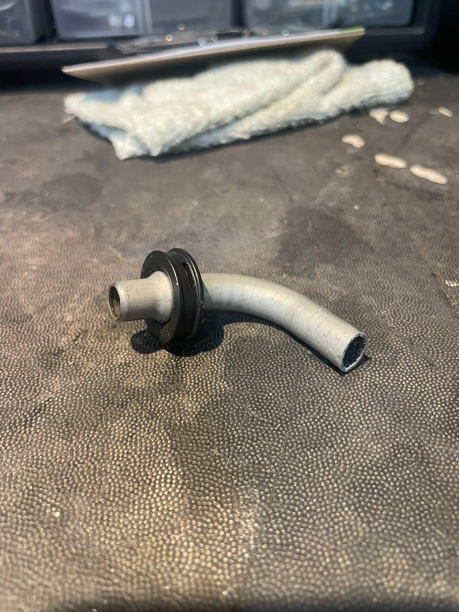

This is what the stub should look like after the cuts.
The modified cooler assembly in place. One hose is connected, the upper one isnt. Note the 2 clamps. The A/C pipe leaves little clearance! Have the Jesus clips in place before installing the lines into the transmission. Then push into place, slide the dust guard over the connections.
The modified cooler assembly in place. One hose is connected, the upper one isn't. Note the 2 clamps. The A/C pipe leaves little clearance! Have the Jesus clips in place before installing the lines into the transmission. Then push into place, slide the dust guard over the connections.

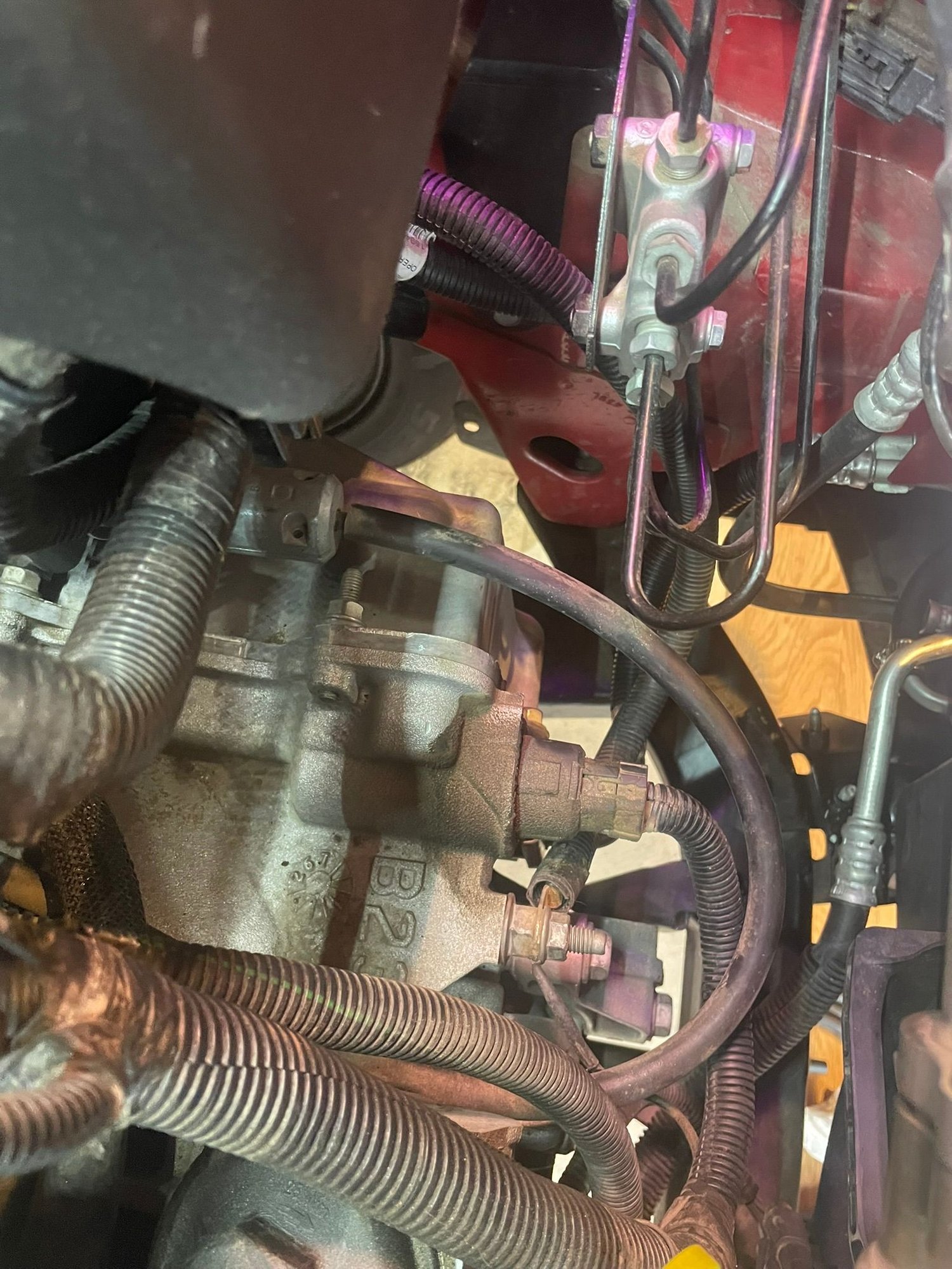

Heres the view from above.
Here's the view from above. See the ground connection on the engine block? Now is the time to clean that connection if you live in a corrosive enviorment and prevent future electrical problems. Disconnect the battery ground first!

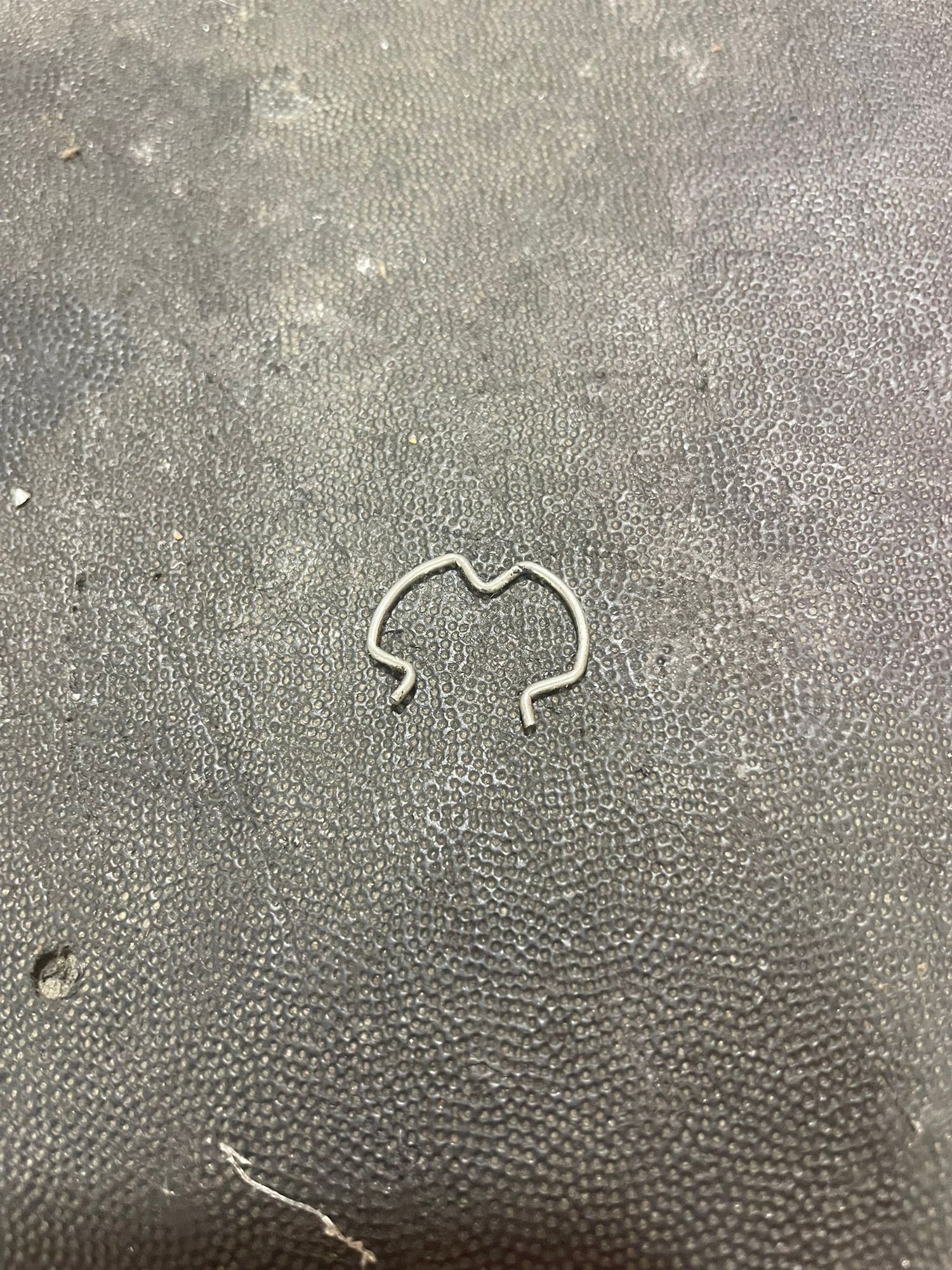

This is a Jesus clip, and holds the cooler line into the radiator. Have extra on hand, you will lose at least 1.

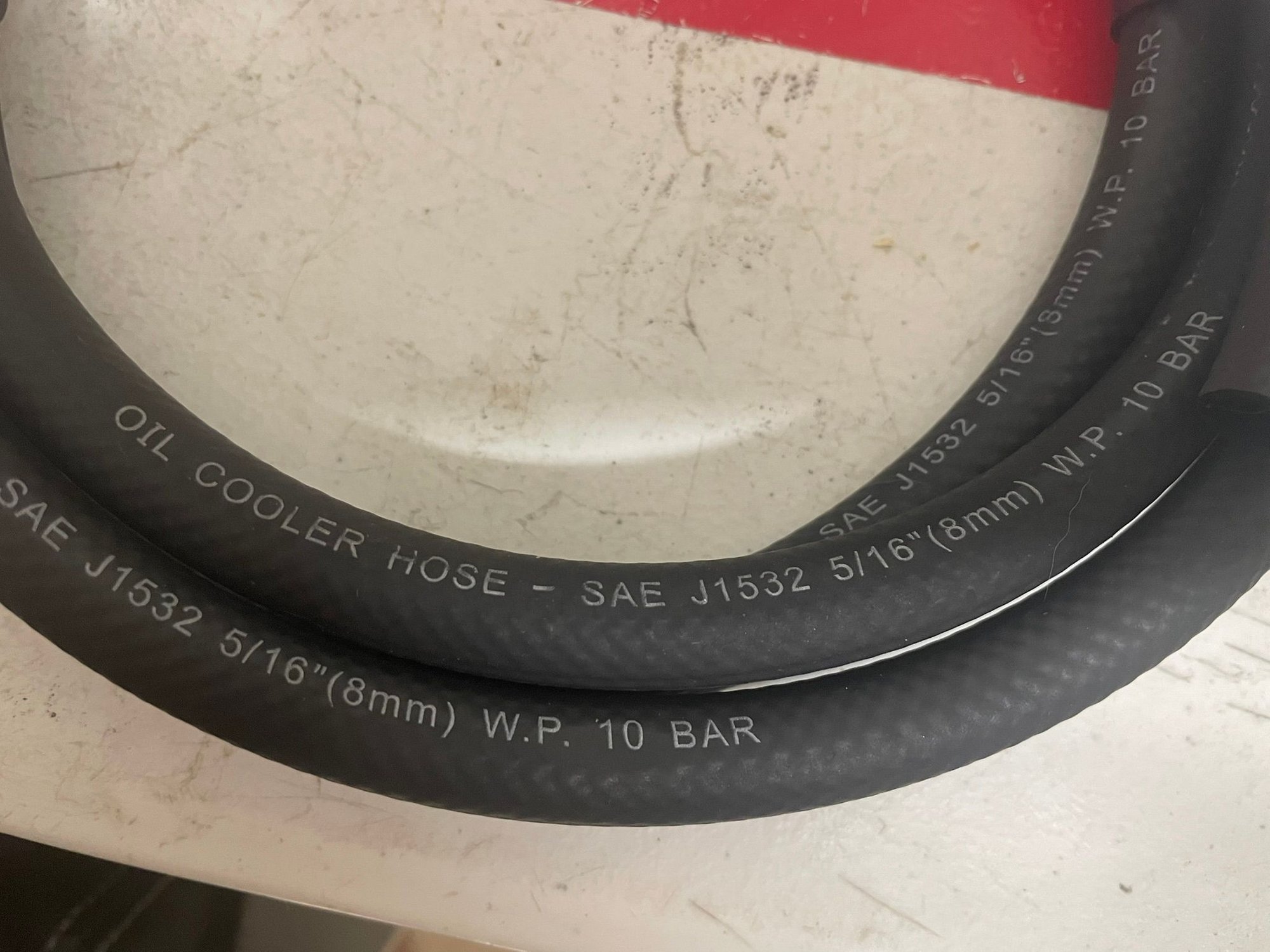

Use oil cooler hose ONLY! I bought mine online, local parts store didnt have it.
Use oil cooler hose ONLY! I bought mine online, local parts store didn't have it.

The cooler is parallel to the radiator/condensor in front of the condensor, behind the bumper. in this position it would not block air flow to the condensor or radiator, but still get enough air to function properly.
I wanted both original rubber hoses kept in place with the replacement GM cooler line assembly because the clip between the 2 lines would function to hold both in place. I left the maximum amount of aluminum line so the hose to the new cooler could be double clamped. Both cuts had to be made right at an elbow so there was enough pipe to clamp to. The cooler line hoses will not come off using 2 clamps. With my last HHR I had a very similar installation and the hoses never came loose in 15 years. The transmission shifted normally at 200,000 miles, too.
This is a better view of how the cooler is mounted.
