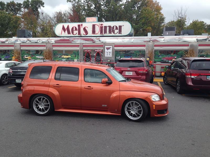

2008 HHR SS 2.0L
Stock Options
Premium pioneer sound system with xm radio, on star, 4 speed automatic transmission, abs, traction control, competitive mode, front fog, driving lights, 18" polished forged aluminum wheels, remote start, 3.29 axle
Modifications
KSport Coilovers (front) with custom springs and KSport shocks (rear)
Zzp 1.25" rear sway bar
14.5" drilled and slotted zzp rotors, Brembo 4 piston calipers with braided steel lines and Ackebono ceramic pads (front)
Drilled and slotted zzp rotors, stock calipers with braided steel lines and Power Stop ceramic pads (rear)
Enkei Racing PF01 18X8+42 lightweight wheels
Dunlop Sportmaxx A 255/40/18 Summer Tires
Bullseye S256et Turbo
Zzp large intercooler and charge piping
Tial 38mm wastegate
zzp 50 mm bov
3" stainless exhaust with zzp hi-flow cat and whisper muffler
Term2 tuned to 25lbs/405whp
Rear wiper delete
Tail light mod is 2 sets of tail, turn, and brake lights
Chrome billet emblems front and rear
