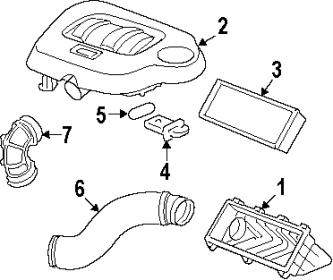

Old Jul 21, 2012 | 12:30 AM
"Not sure if the recirc turns on the ac compressor on these or not, but the snowflake button is not lit up."
No, the A/C compressor is off in recirc mode. Unless you push the A/C button to on..
I agree w/others, check air filter first..(see pic). Any good CLEAN air filter should improve mileage.
My 2.4 is averaging 30ish mpg @ 70 mph.. (but my tires are a tad taller to be fair)..
Then maybe re-set the ECM
