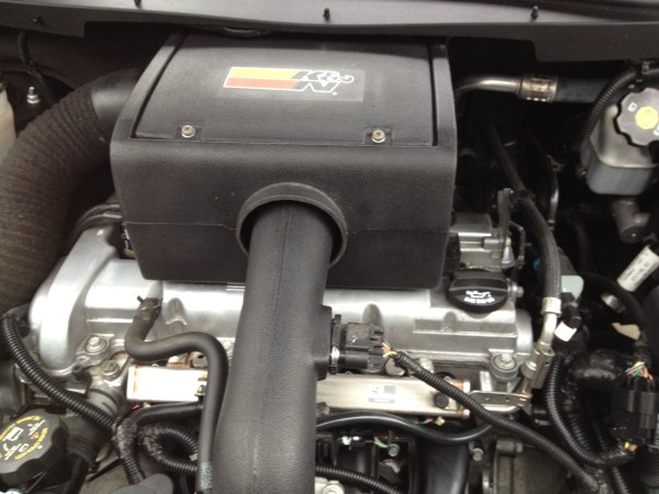

How effective is the K&N airbox at increasing airflow?
Old Jan 4, 2015 | 01:56 PM
I noticed a little difference with the K&N, but I added a Trifecta tune at the same time and that helped, especially the tranny tune. The K&N definitely made it sound better........
The 2lt comes with the same muffler and tip as a SS, so I wouldn't worry about back pressure.
