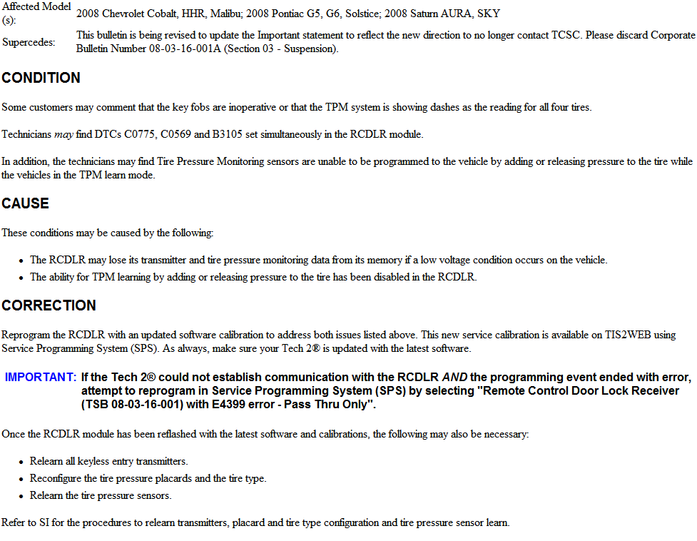

If the battery has been dead then the RCDLR will likely need new firmware installed. That would not prevent a startup.

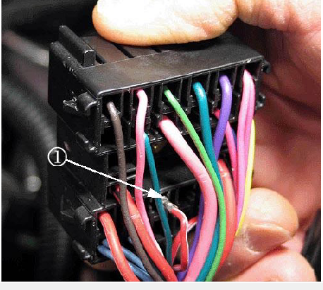

There has been problems with the halves of the underhood fuse box getting loose and the connectors on the bottom of the fuse box. Look for this kind of thing:
Attachment 22002
Attachment 22001

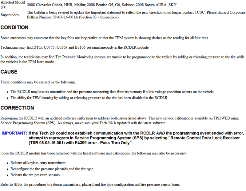

Attachment 22002
Attachment 22001

we are going to do the fuse cover removal cleaning process to check first, thanks for that information.
