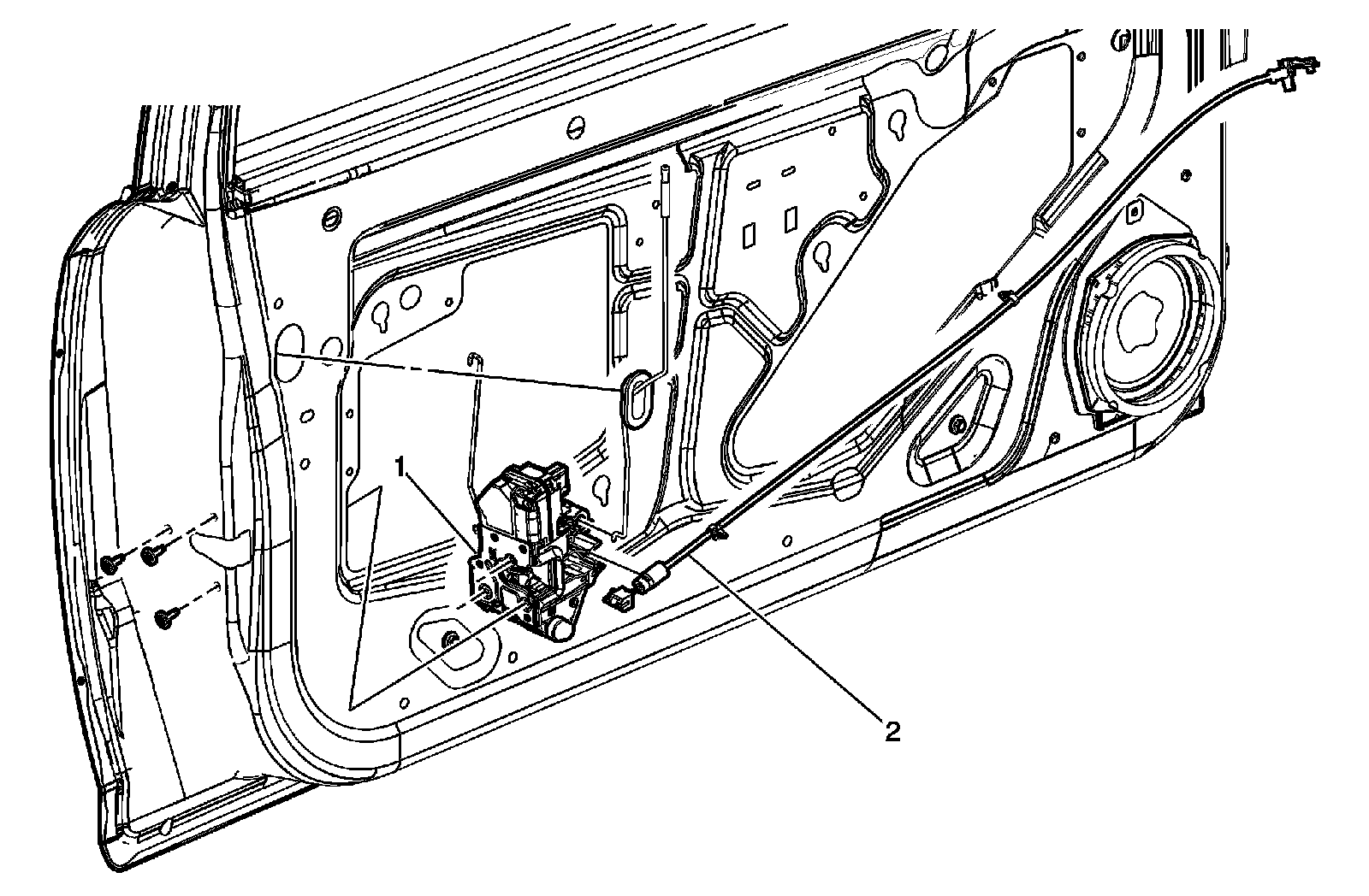

Home >> Chevrolet >> 2011 >> HHR L4-2.4L >> Repair and Diagnosis >> Body and Frame >> Doors, Hood and Trunk >> Doors >> Front Door >> Front Door Handle >> Front Door Interior Handle >> Service and Repair
Front Door Interior Handle: Service and Repair
Front Side Door Inside Handle Cable Replacement

Appreciate the response So what is part number of cable?

It's been out of production for so long that it's not even listed anymore. Best bet is auto salvage yard.
You may be able to get the latch and cable assembly still. Which door is it?

It appears the cable comes with the actuator, but I would check salvage yards first
https://www.rockauto.com/en/catalog/...or+latch,10748
I found this on EBay
https://www.ebay.ca/itm/256227746075...mis&media=COPY
