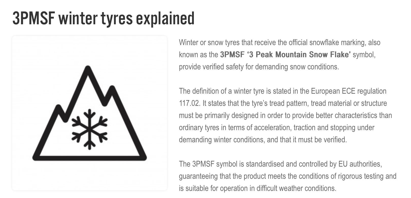

Tires vary wildy in snow and ice perforance, and rubber compound is a big part of it. Sounds like yer new tires are best reserved for Summer duty.
My next set of year-round tires will have the "three peak" stamp. Mandatory in parts of the EU in Winter, I understand. A few all-season tires in the U.S. are thus marked. Most aren't.
Ive had great luck with these tires, had them on my 08 and now the 09, just my drive is a steep grade so it makes it more difficult, Im surprised as this is the first time Ive been stuck and the tires were replaced just about 2 months ago so great threads on them.
