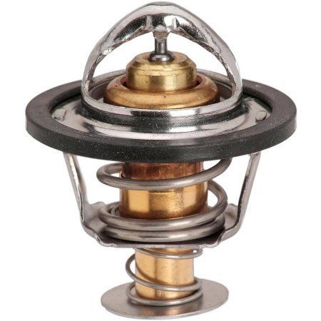

Oldblue May 15, 2018 06:13 PM
AC Delco 131/158 thermostat no relief valve
https://cimg2.ibsrv.net/gimg/www.che...7c89fd0cd.jpeg
