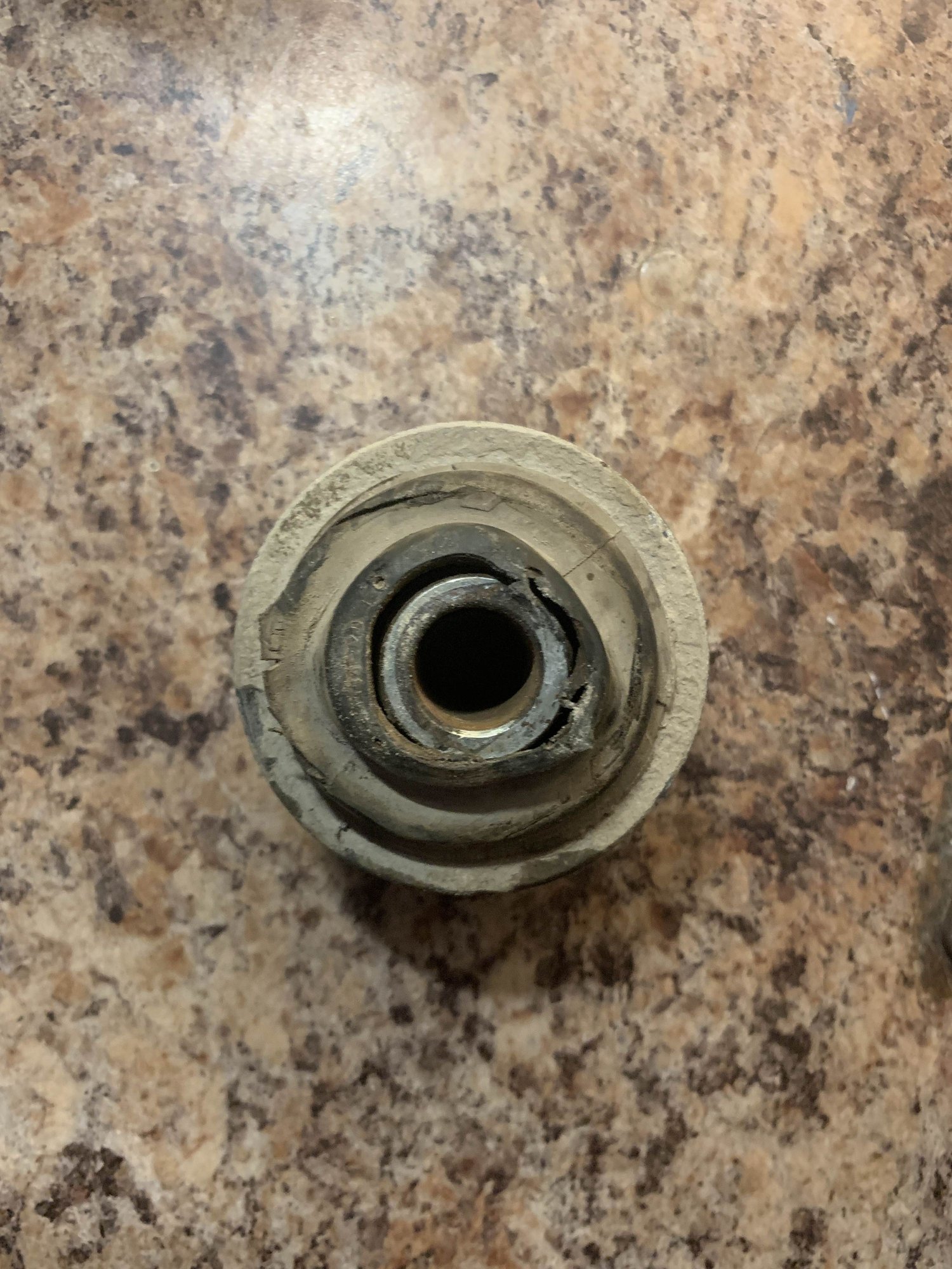

A bad shake has developed in my relatives 2008 Chevy HHR SS. I can replicate it by getting up to highway speeds and letting off throttle. Certainly feels like its coming from the front passenger. We have replaced a CV axle to try and fix the issue. After installation it seemed to help a bit but the noise and vibration were still there. Some time has passed since the new cv axle was installed and its gotten worse. The only way to have a somewhat smooth ride on the highway is to constantly have some load on the drivetrain.

Welcome to the site, the lower control arm rear bushings could be worn out, or the ball joints . ZZP offers LCA’s either new correct ball joints and FE5 rear bushings.

Old Oct 20, 2024 | 05:14 PM
mhSS's Avatar
Joined: 10-04-2024
Posts: 13
From: OH
Thanks @Oldblue for the suggestion to check the rear bushings on the LCA. The rear was indeed shot. New bushing installed and now we are smooth at highway speeds. Thanks everyone else for the help and suggestions!
