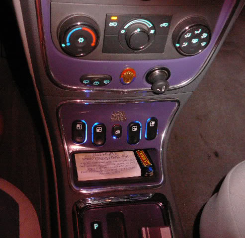

I used the blue LEDs but mounted them to the switch housing. They illuminate the gap around the switches. Wired them into the wiper switch light wires so they would only come on with the dash lights.. Looks nice at night. Haven't figured out a way to take a picture that would do the look justice. Also laid a piece of tail light repair tape over them to get a more purple look to the light.

That's what I was originally going to do, but I couldn't get the look I wanted without using like 8-10 Led's. I may re-do the wiringto the wiper wires (they are right there) but I'm kinda getting used to the LED's being there during the day...lol....and believe me I know all about the picture senerio....My camera, interior lights, and darkness just don't get along...lol...regards

I used a 3 pack of LED lights I purchased at Autozone. Put some reflective material at the top and bottom of the switch housing. Hard wired to the light wires to the rear window wiper switch. Turned out good enough for goverment work. LOL

Looks awesome.....The reflective material must be the key, because I had like 3 or 4 LED's all over and just couldn't get a good look to it. Did you put your lights between the switches, or did you mount them at the top?

I put one light between each of the door switches and one light below the lock button. All were mounted on the lower side of the switch.
