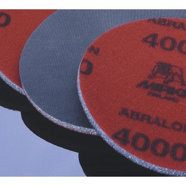

Wetsand with these. Super smooth.

Mirka Abralon Pads - 4000 grit. They come in 4000, 3000, 2000, 1000, 500, 360 and 180 grit.
https://mirka-online.com/abrasives-b...lon/discs.html
