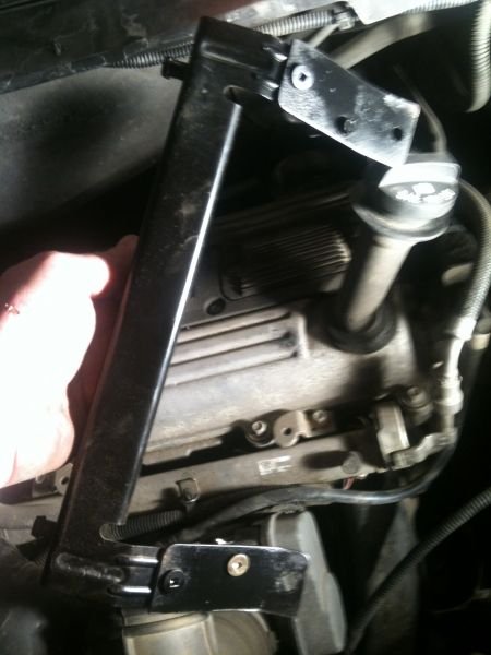

Perhaps a video with sound and a test drive so we can hear it? Or we could guess , but there’s no prize for that correct answer. Look at the heat shield over the cat con, and the air box bracket, they tend to flex and break.
Here is a busted one repaired

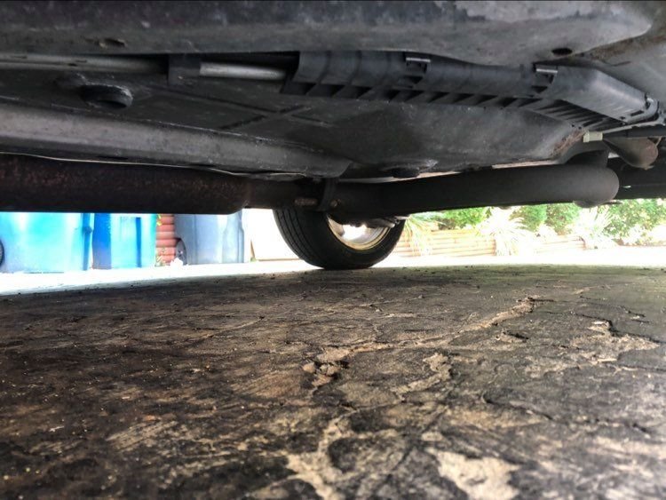

More like a rattle, but there is nothing loose under the car that I can find. It doesn't do it all the time, but does it more often than not. Annoying as hell too. Only other think I can think of is inside the muffler or cat. The system has been welded like someone removed an aftermarket system and put this back on as there are some "spacers" welded in so the exhaust hangs a little lower than its supposed to and not tucked up where it should be.
Old Jun 19, 2020 | 12:43 PM
Posts: 40,082
A photo of that possibility.
Old Jun 19, 2020 | 02:00 PM
Posts: 40,082
The shield looks bent in this photo are the rivets loose ?
everything is tight. The exhaust can be shook by hand but nothing hits anything or rattles as well.... just odd
