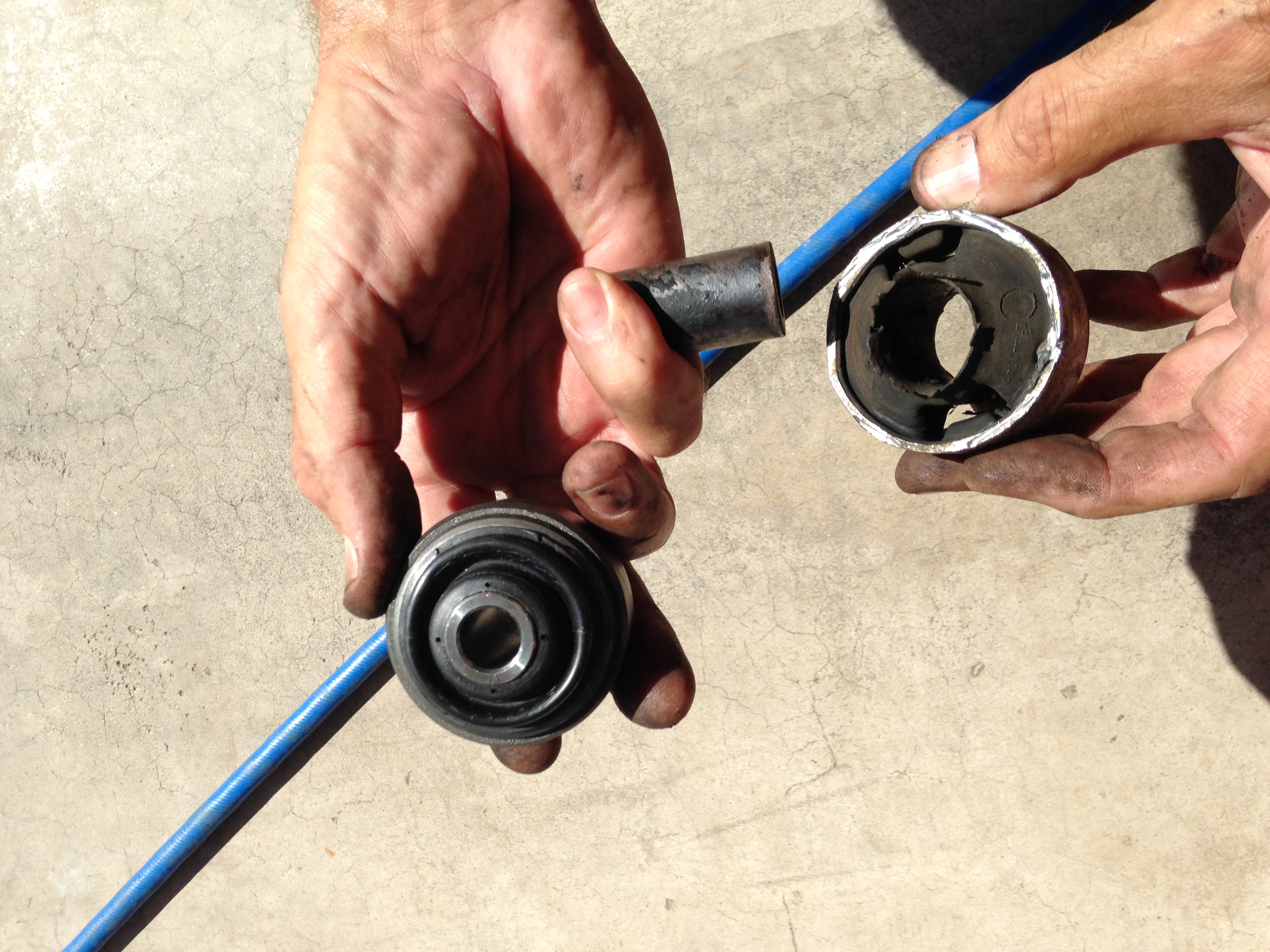

It's abut of work drilling out the rivers for the ball joints , pressing out the worn bushings and in the new , but you'll not be changing them out for quite awhile!
These are my rear bushings with just 40,000 miles! The new Moog bushings have about 120,000 in them now!
