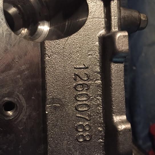

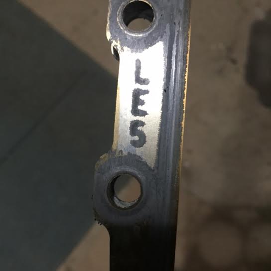

Head Good. Is this motor a LE5 or LE8 ?? The Factory Hear gasket is stamped LE5 and the casting number is "1200788" Anyone has verification for this head or block casting numbers ?

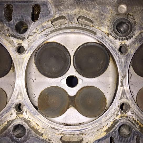

Cylinder head is NOT warped and the Machinist told me that "This cylinder head was NOT overheated, and all Valves are good" !! And that there were no indication on the head or head gasket of coolant leaks into cl head etc...

The RPO is a LE8, checked it three times. But, the Cylinder head is used on a LE5 and the 2.2 castings numbers that I found did not match this one. But, We all know lots of heads get on many engines...

A 2.2L head gasket won't fit a 2.4L head. All 2.4L have VVT no LE8 have VVT, the heads are not interchangeable.
I think that the bore is different between 2.2 and 2.4; if someone put a 2.2 head on a 2.4 block or vice versy: water in oil.

I don't have any way to track casting numbers or valve cover numbers.

The head gasket is stamped LE5
