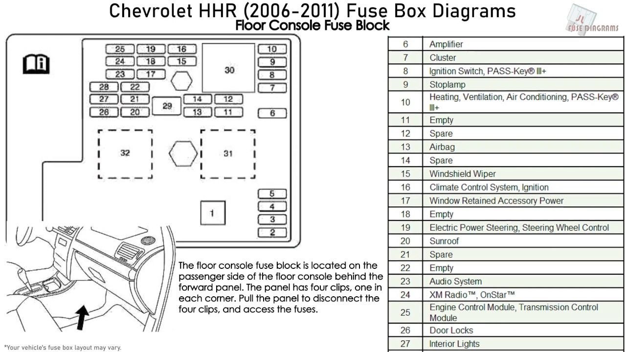

To answer your original question; Run wires anywhere you want, under the carpet, under the door sills above the headliner. All of those options present some engineering. All of the "not used" fuses in the BCM are switched through the RAP relay (they stay on for a bit after the key is off).

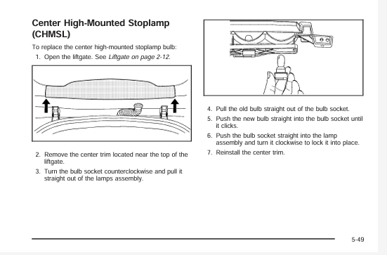

What I need to know is.... How do I remove the 3rd brakelight panel so I can access that area for wiring?

From when I took mine off.
Yank it. Hard. The clips that hold it up are really strong.

The clips holding that are really strong, held so tight one of them broke off.

Did you look in your Owner Manual under "bulb replacement"?
This is from the 2009 OM

So I tested the fuse block with a test light and the empty space #22 was switched power On/off with key and no delay. So, I installed an add a fuse, and grounded the socket to the metal tab for the kick panel tab. I used a 5amp fuse as it shouldnt be drawing much power ( I have a 3amp fuse as well ) but figured the 5 amp would be best. I tucked the socket with the power outlet under the carpet under the kick panel so there is no rattling. Everything working as it should. Once it starts cooling down outside, I decided to move the rear camera under the rear trim by license plate as the camera gets a glare from the glass at night, will have a clearer view at night but may not have the angle that I like as it is up higher... oh well, we have to give a little I suppose .
