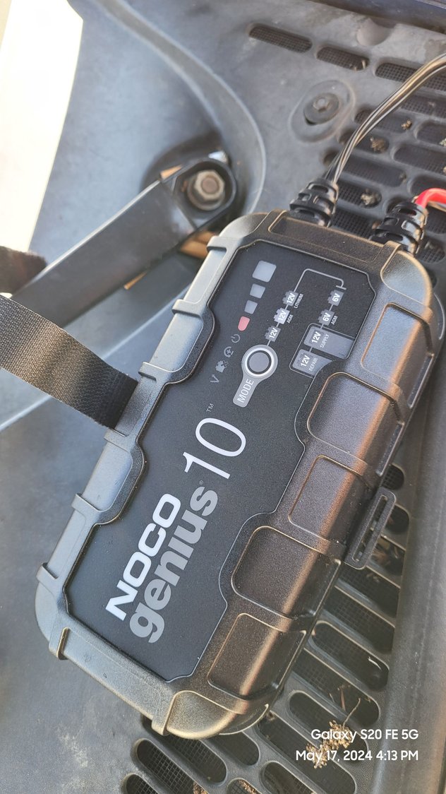

I have a big agm and they need over 13.5v to charge.
Had to grab this to keep it topped up

I've got the noco genuis 10 charging over night and it was at 14.1 when I got up. So the 1150cca northstar is getting over 13.5v like it needs.
