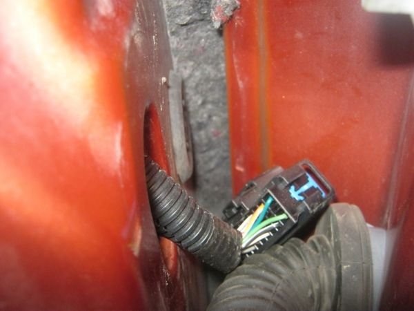

My driver window will not go down I already replaced the regulator / motor and the window switch and it still won't go down does anyone have any suggestions? It's a 2008

Check the ground wire, check electrical connections in the door hinge area where the rubber bellows seal is

But do you know the best way to get in there?

Some remove the fender , some the door, some just reach on in there and remove the rubber boot.
