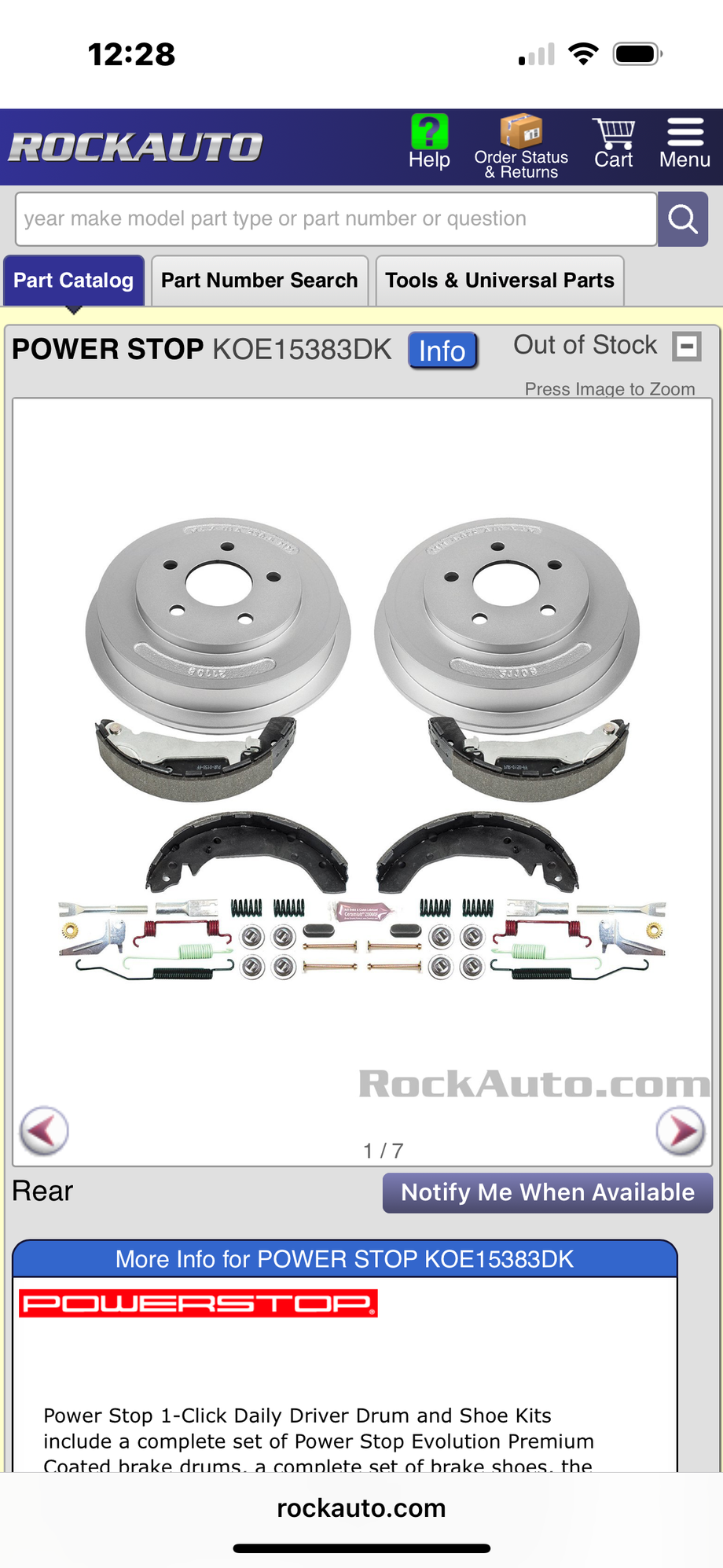

Power Stop had a good kit, I installed one in my 2011 , to ensure I got the right parts in one package
This kit, I purchased from Rock Auto, they are currently out of stock but you can click on notification button.
