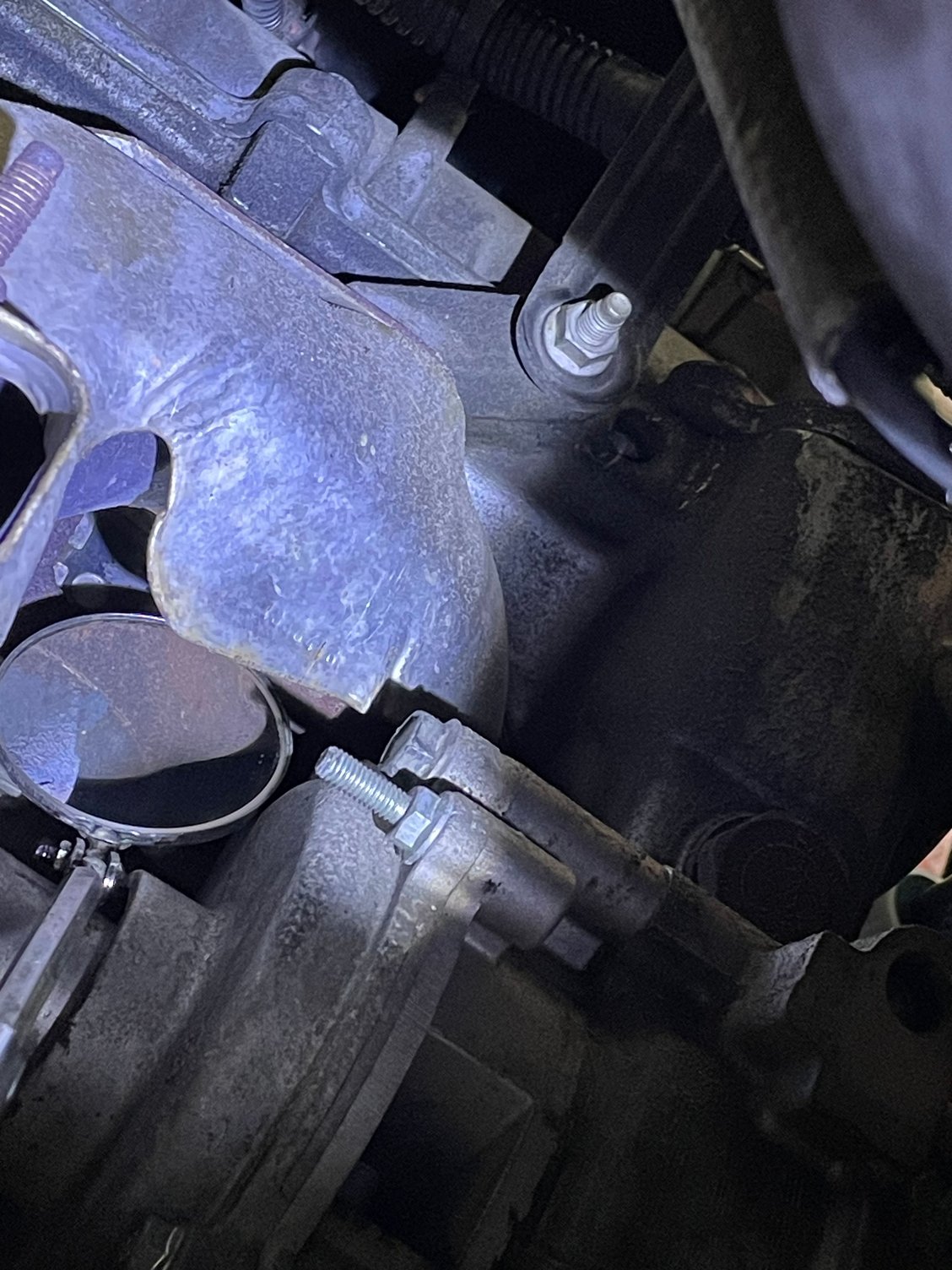

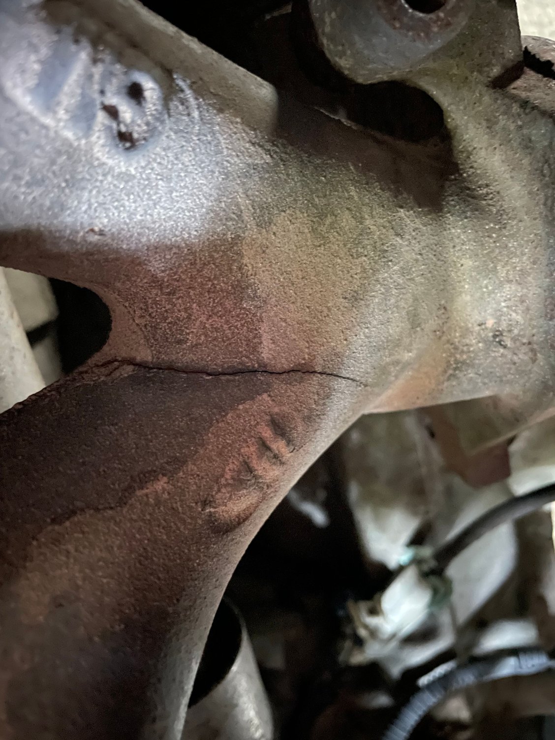

On 2011, LT, 2.2….are these known to crack? Looks like what might be crack in mine. Pic quality not to good….difficult to get good pic
Suspicious looking line I can see in inspection mirror. What do yall think?

More info….the car seems little louder recently and sounds kind of like rushing air when under load like up mountains or accelerating.
120xxx miles since chains and guides….checked for slack in chain yesterday….no slack.

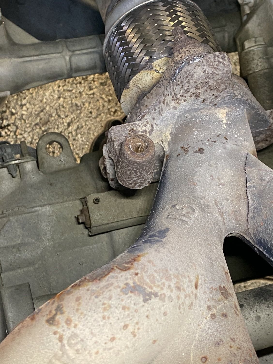

What about the flex pipe ? They are known to fail pretty often. Usually caused by weak/bad engine mounts.

I have heard that also. I dont think I have bad mounts but I will make sure. My thoughts are…if the manifold is cracked and I need to replace it….just replace flex pipe while I’m at it. The car has 228xxx miles on it. Had 109xxx when I bought it…I have never changed any exhaust parts.

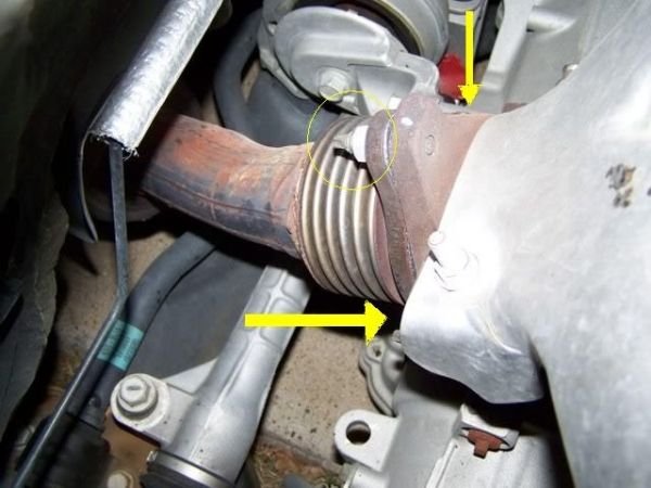

Posts: 40,082
Take the heat shield off to see the manifold and flex pipe better
This shows the usual location for a cracked manifold
This is the heat shield, you can see the flex pipe above the yellow arrow

My flex pipe looks more like the first pic you posted…with the cracked manifold

Mine is little toward bottom edge….the hex bolt head is even with bottom of slotted access hole.
Manifold definitely looks cracked to me…
