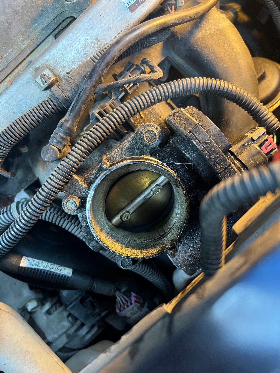

Doesn’t appear to be any engine damage anywhere just to the ac condenser, the ac line has barely pushed against the throttle position sensor on the throttle body.

The throttle body is in need of a good cleaning or replacement, the butterfly plate is open to far.
