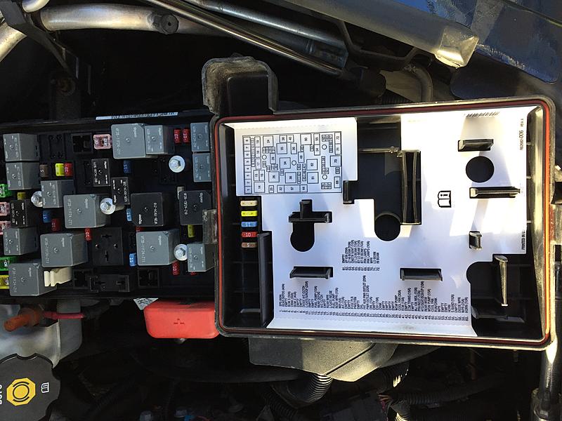

Old Jun 12, 2017 | 11:40 AM
Posts: 40,083
Here's a shot of my fuse box lid

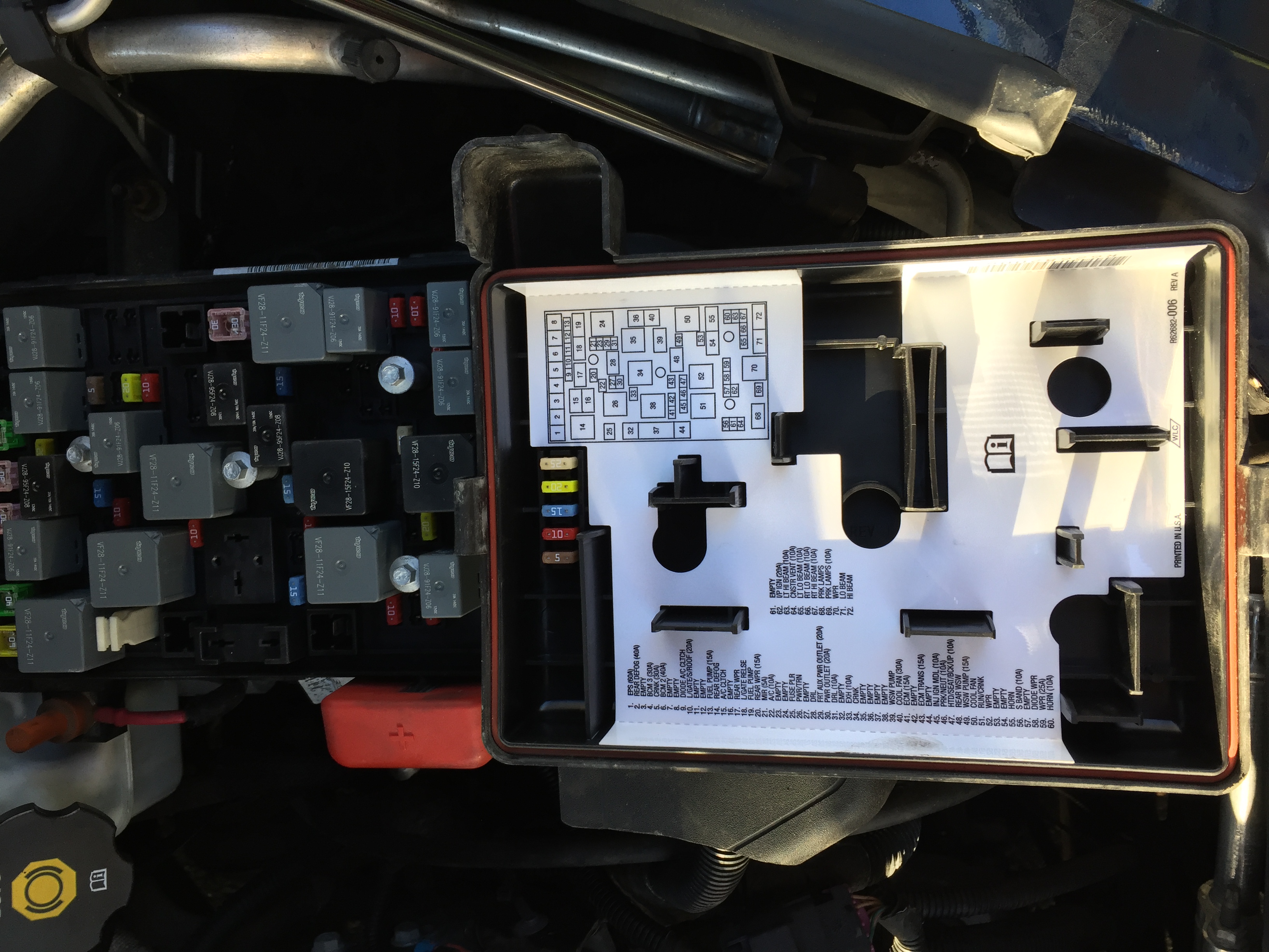

Old Jun 12, 2017 | 11:41 AM
Posts: 40,083
Better shot

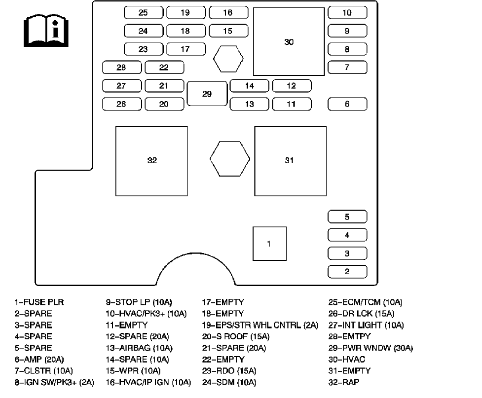

Old Jun 12, 2017 | 12:52 PM
Posts: 26,532
And more pictures of what is supposed to be under the lids.
And a pdf file that you can read a bit better.
