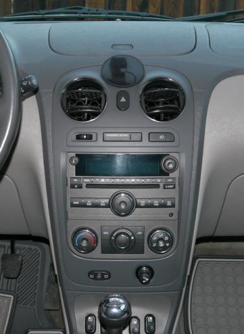

Here is where a previous owner placed the Garmin supplied GPS mounting circular pad in my HHR. It works great and clears the vents and dash storage compartment!

I may try it there. I also was thinking of removing the dash compartment door and mounting it in there.

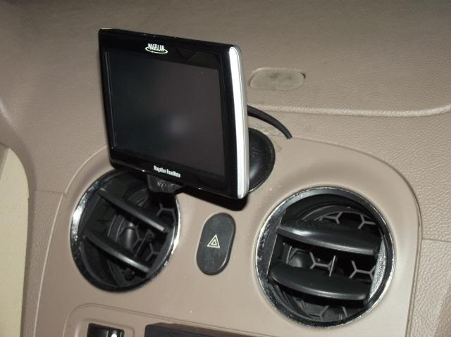

I had tried that but found that if the car sat in the sun for awhile the suction cup would lose grip and the unit would fall off. After a couple of times finding my GPS lying in the floor I removed the suction cup from the mounting base and glued it directly to the top of the waterfall. While I was at it I notched the top of the waterfall to run the power cord into the space between the vents. I then spliced into the wires feeding my cigarette lighter and ran them up to a aftermarket lighter socket that I plugged my power cord adapter into and wrapped it with electrical tape to keep the connection fro shorting on anything. Works great and no more having to pick my GPS up off the floor.

Mine will fall off the winshield. Not sure I like the idea of glueing too the dash , but may consider that
