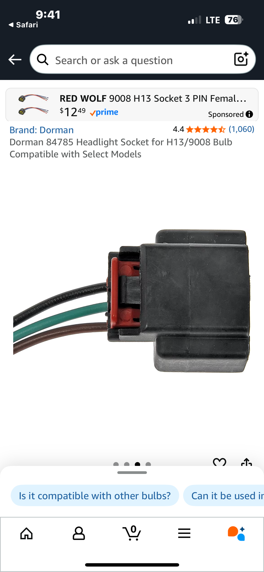

Posts: 40,082
Dorman 84785 I see lots on Amazon here in Canada try searching that number in your eBay
Cut and splice one wire at a time .

I see this part on Amazon and the colors probably match what's OEM, I'll have to check but the tradeoff is the Auto Zone parts come with the shrink tubing and connectors.
