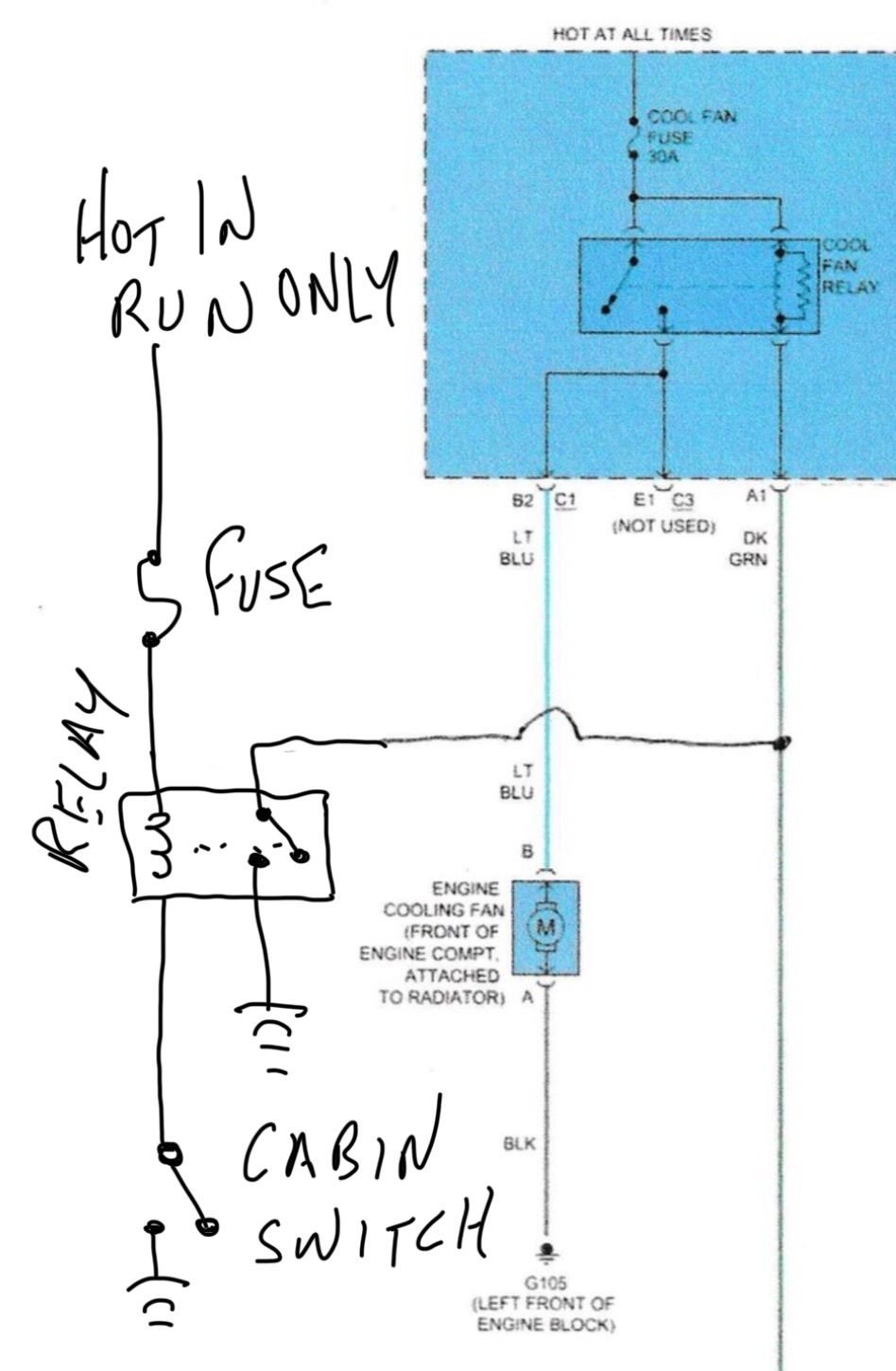

Desertrat, you've given me an idea of where to look for a short in wiring of my radiator fan (the dark green wire or equivalent for my 2.4). I have had this on my to-do list for a couple years now ... Anyway, in my experience, my radiator fan turns on the second I turn the key, and stays on for about five minutes after taking the key out. So I'm guessing it's either a problem with the fan module, or a short (maybe in the dark green wire). I already checked the fuse and relay, and finally just removed the relay since it's not too hot in Minnesota. Did you end up installing what you were talking about?

Back to the proposed switch, if you forget to turn it off, it will run the fan until the battery’s dead. Better to add a relay with the coil fused to someplace hot in run only, so that it no longer activates the fan relay once the ignition is turned off.
Disclaimer - Concept only. i’m not an electrical engineer. I have no idea if the fuses really needed or what its rating should be.

My theory is don’t mess with it! After 15 years of seeing all the electrical issues members have had. Leave it alone!
