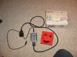

I just bought a Used HPTuners Pro with 0 credits left.
I don't plan on tuning anyone elses cars so had no real need for the 8 credits it comes with New.
Even with buying the 2 credits ($49.99 each) I will need, I saved a few hundred bucks buying it used.
Watch the CobaltSS.net forums for a used one to pop up and save a few bucks.
They sell FAST, those young adults are always performance modding then putting back to stock at trade in time.
Seller I bought from put it up at around midnight my time, I saw it within minutes, contacted him to make the deal and 3 other vultures were swooping in trying to buy it for thenselves. HOW DARE THEY !
Took me awhile to catch a used setup even watching those Classifieds like a hawk they sell damn quick. I wasn't in a real rush so I kept waiting to Pounce when one was available.
The Pro allows you to data log without a laptop sitting in the car with you, you can read up on both on their website.
