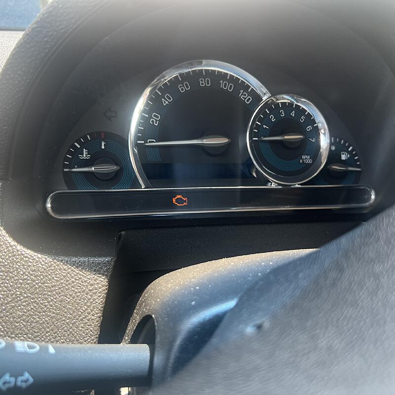

My HHR is my first car ever, so I have no previous experience with vehicles. I received this car with both the stereo and its trunk locked by its anti-theft system, and after a year of usage, my car battery died. I’ve been having this issue where every time I replace the car battery, it only lasts a year, and just recently, my instrument cluster would just go crazy; my gauges would just drop and start shaking up and down as a noise came from the cluster. After a while of just ignoring this issue, my instrument cluster stopped working completely, and only the lock light turns on, so my speedometer won't show my mph and my fuel gauge won't show how much gas my car has. My HHR is basically unreliable, and I was wondering if there was a fix to this that I could tackle myself because I'm short on cash or if I hit a roadblock and should get a new vehicle?

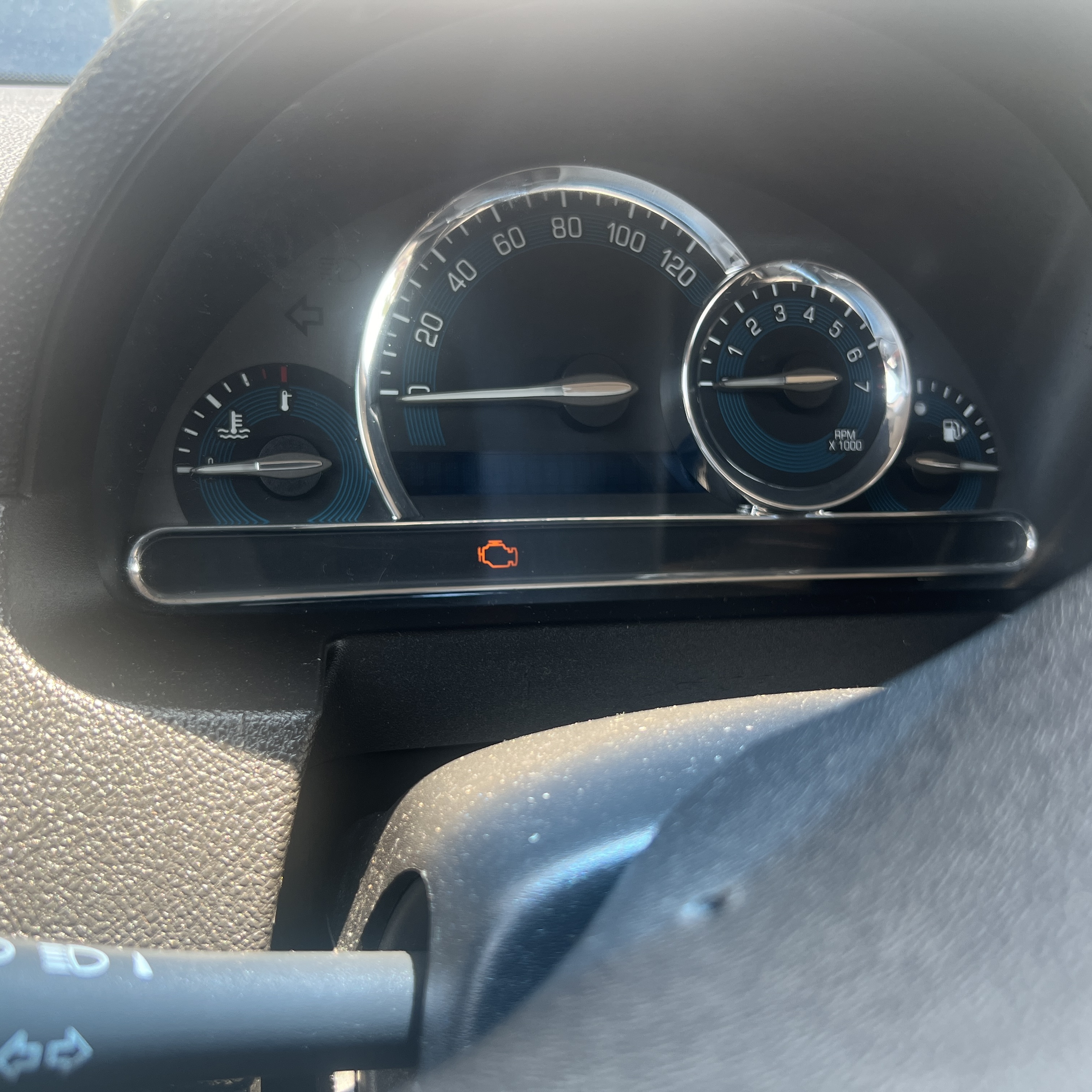

I believe we received the car in its "stolen" condition, and the owners knew they just said it was like this because they swapped the battery, but my mother bought it with the idea that we don’t need a radio or a trunk as long as it drives perfectly. That's all that matters, you know. So the car was my mother's, but she stopped using it once a bunch of the issues mentioned in the previous post popped up. Nothing has been done to unlock the security system because my mother didn’t receive a manual with the code to unlock the vehicle. The brake lights aren't on when the car is in park. I believe the radio is stock, and it doesn't remain on when the key is not on ignition. From what I know, we haven't put in any aftermarket equipment, and we really haven't done much work on it besides changing the oil, tires, and fuses. The check engine light is the only thing that does turn on with the lock symbol in the instrument panel. Chevy HHR LT 2.2L Flex Fuel (E85). One last thing: just now, when I went to go check the vehicle, I noticed that when I turned the vehicle, my speedometer was shaking up and down at zero.

Check engine light means exactly that. It is lit up because it’s telling you something is wrong. You need to have the system scanned for trouble codes. Those codes tell you where to look for the problem.
Most auto parts stores will scan for codes.
Get the codes and post them here.
Codes numbers only. No descriptions.
FYI. There is no “code” to unlock a HHR. If you meant no Owners Manual. They are available on this site for download. FREE !

Tighten the 4 bolts in the under hood fuse box, make sure there is no fuse in position #11 and the fuse in #10 is good.
