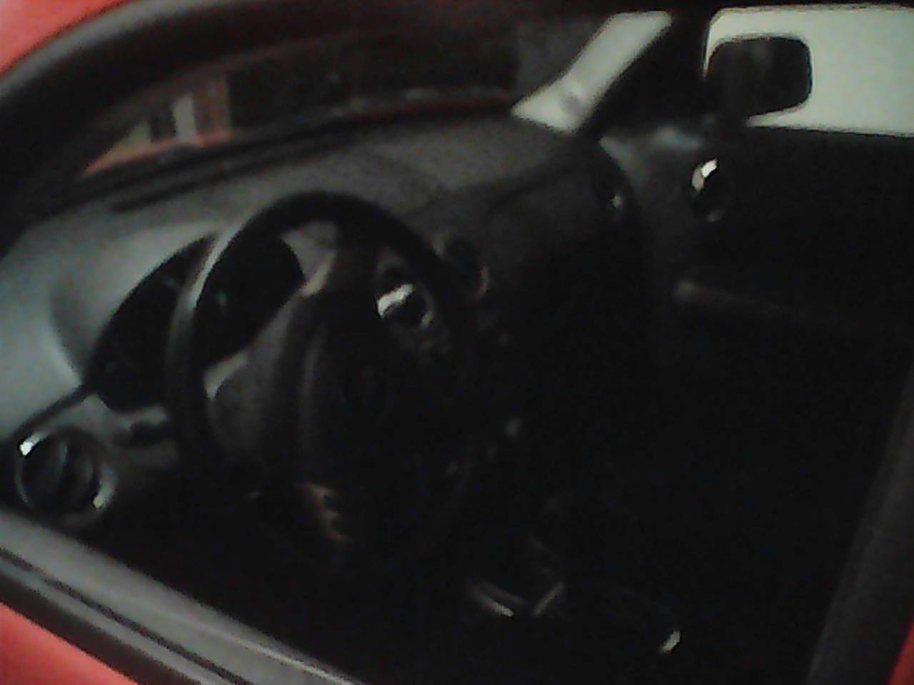

the interior of the car is in very good shape

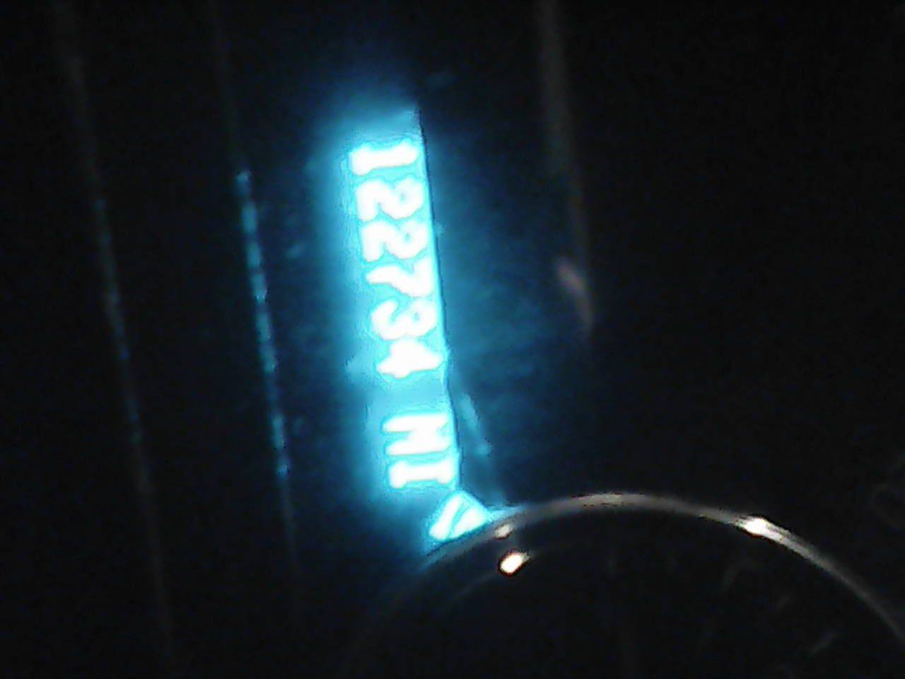

122,734 miles on this thing

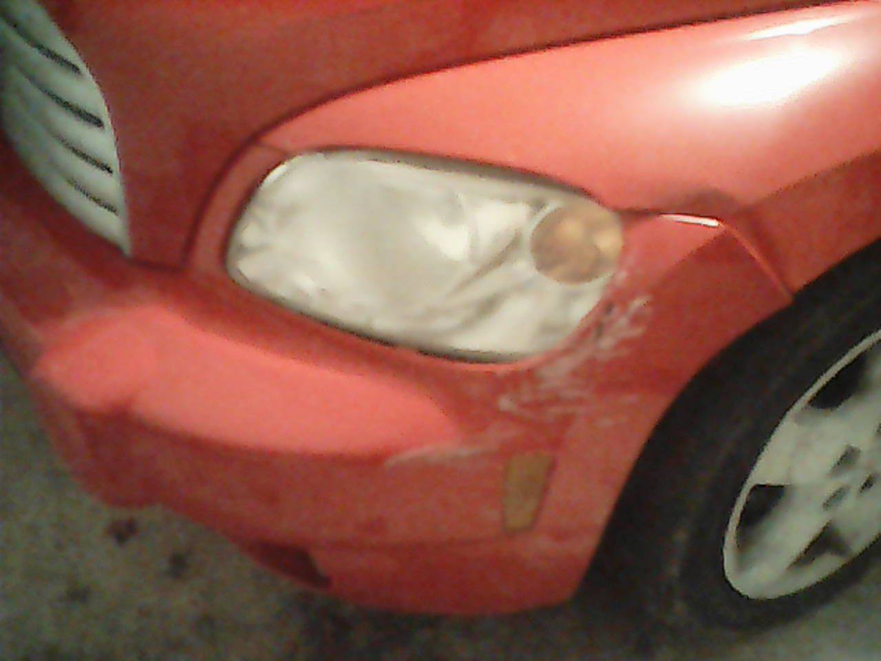

This is the damage from the garage door.

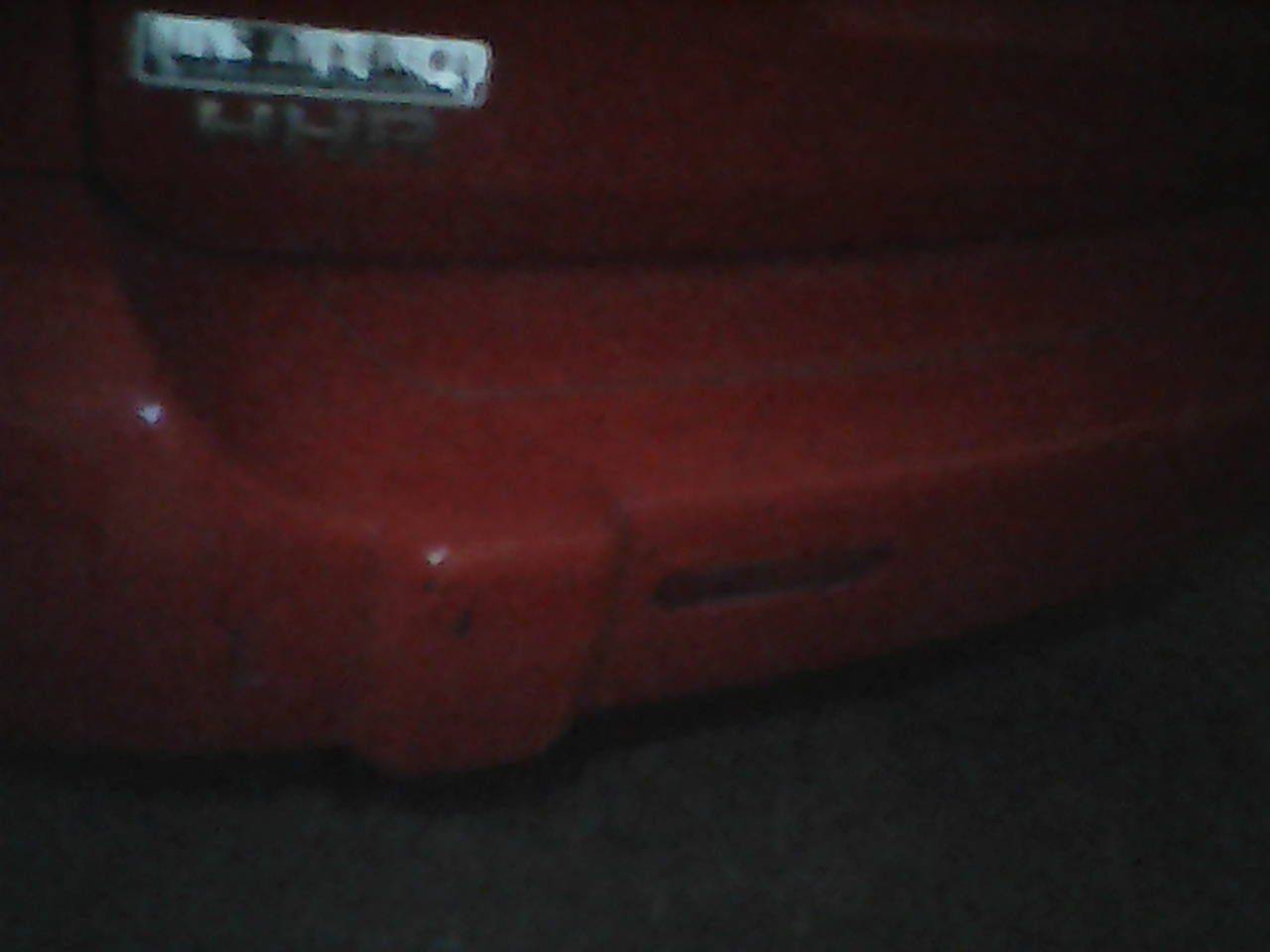

its kind of hard to see, but there is a crack in the body on that weird rectangle thing that sticks out
