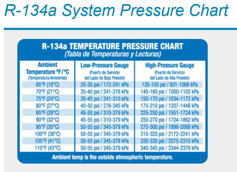

Are you 100% positive that's taken on the low side? The reason I ask is this chart. See if you can get your hands on a good set of manifold gauges for this. You might be able to rent some or go to a place and ahve them check.
