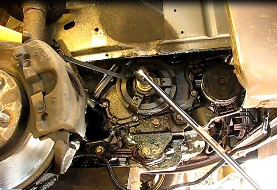

Posts: 40,083
This Ecotec isn’t in an HHR but the photo demonstrates the oil being slung and blown back along the engine.
