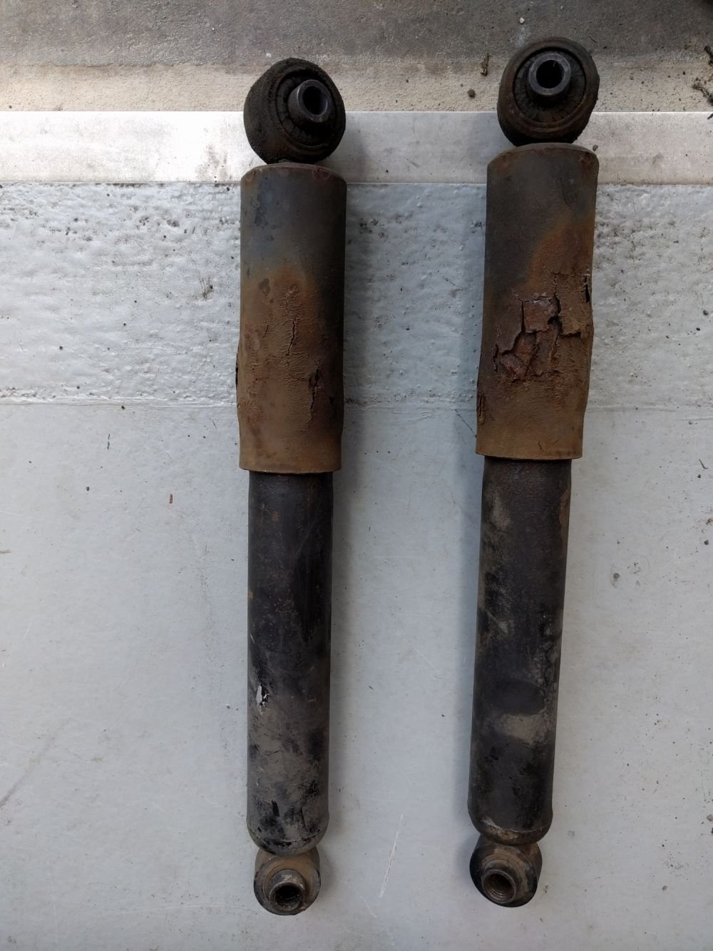

That's how my KYB rear shocks looked after 8 salty winters in Switzerland. The thin metal covers were completely rusted through.

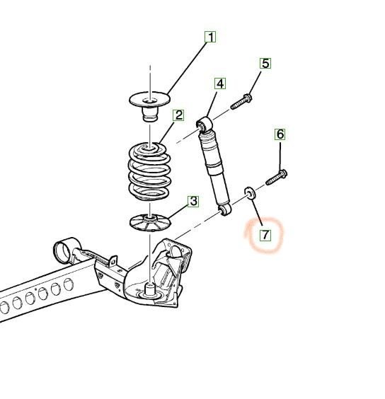

By the way:
- on the lower mounting bolt, there is a washer. Where is the washer supposed to go? On the inner shock side between axle and shock or on the outer side between shock and bolt head?
- as both upper and lower bolt threads seem to be at least partially exposed to salt and water, would it make sense to cover them with antiseize? Or rather some threadlocker?

Painting - Blue is right, everything is already painted at the factory. And yes, there is a very good paint job there. If you are afraid of corrosion, simply cover the shock absorber with an anti-corrosion coating, Movil or similar.

The purpose of a washer is to separate a nut or bolt head from the adjacent surface. The washer prevents the fastener from loosening. In our case, the washer separates the bolt head from the shock absorber.

Ok thanks, good to know

Shock absorbers are good for only about 50,000 miles. After 8 years you are probably over due any way.
