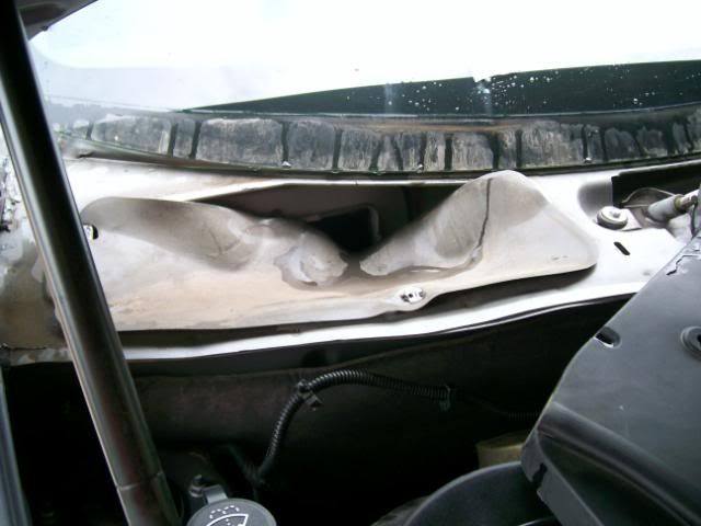

I have a rain/water leaking pretty significantly from below the dash/glovebox area. I searched the forum for rain/water leaks and haven't found anything about this particular area. Just wondering if anyone had rain leaking in on the passenger side floor from underneath the glove box area and what they did to discover and fix it. I'm hoping someone can help me minimize my time trying to find the source of the leak. Thank you.

Posts: 11,721
I always thought this was a great picture. Shows the where, what and why the water leaks into the HVAC box.
Pictures do say a thousand words.

George's picture is priceless.

Now these are George’s pictures!
https://www.chevyhhr.net/forums/main...l-patch-58597/
