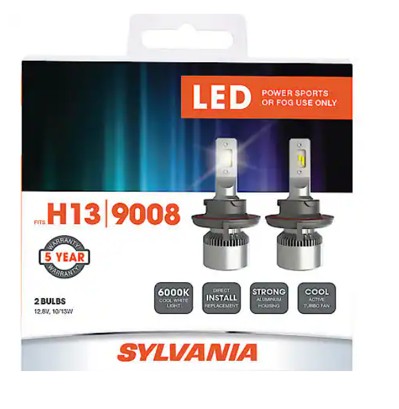

Using these since June '24 and no issues. No flickering.

The Sylvania or similar with the flat two-sided configuration will likely give the closest to the proper light pattern.
