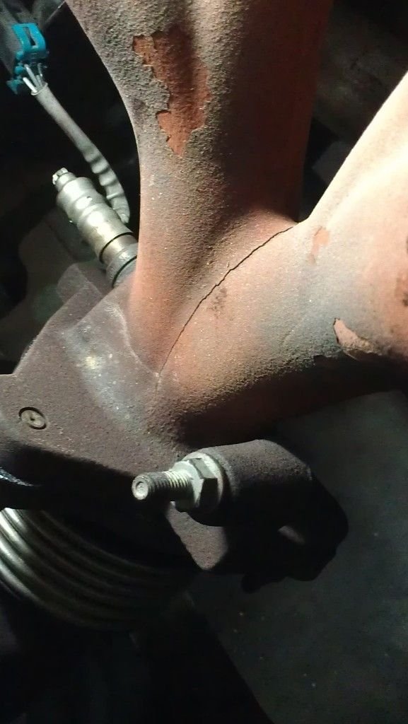

Old Jan 13, 2023 | 12:30 PM
Posts: 40,082
The heat shield has been removed, see the O2 sensor in the manifold and the crack in the manifold

hi Oldblue if the crack is in the manifold, what can I do? replace or is possible to weld?, thanks
